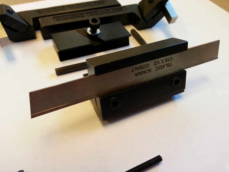

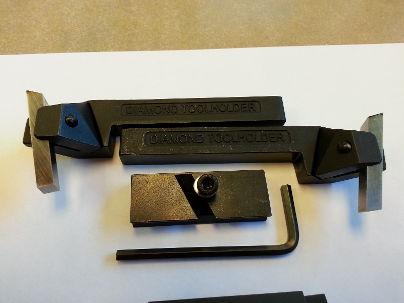

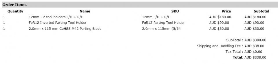

I just ordered the 16mm L/H and R/H Diamond Tool Holder kit for my PM1340GT lathe direct from EccentricEngineering in Australia for $235 Australian. I was concerned about the weight for postage purposes, as nowhere have I found weights provided for the kits. I ordered just the kit and no extras so the weight was in the .5 - 1 kilogram range (essentially 1 - 2 pound range) for a cost of $38 Australian. Total bill was $273 Australian or $238 US plus some change. Will be interesting to see how long it takes to get here. I have some 5% and 8% cobalt bits in 5/8" I will try with this kit. Stay tuned.
JPMcConnel
Jan 21, 2012
50
Fairfax, VA
The Diamond Toolholders arrived from Australia today; eight days from date of order to arrival at door is pretty darn good. Tool quality appears very high and I can see where a step provision has been made in the tool holder itself for an adapter to allow the use of smaller tool bits (except I didn't order the adapter - of well). Can't wait to start using the new holders. I also ordered cobalt-HSS tool bits that are 5%, 8%, and 10% cobalt in 5/16" square by 2.5" long to fit this tool holder. I ordered 5/16" round tool bits, but they are not available in cobalt from ENCO. A tool bit sharpening jig is also provided to allow you to properly sharpen the bits. Cool.
