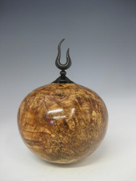

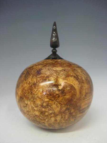

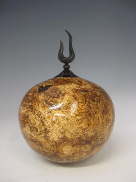

I bought some really soft spalted maple burl from isaacrapelje a while back, and I turned this form a few weeks ago. The burl was so soft that I ended up soaking the roughout in 50/50 white glue and water mix for 24 hours then finished turned after it dried. That's a neat little trick for really punky pieces if you don't have a stabilization chamber.

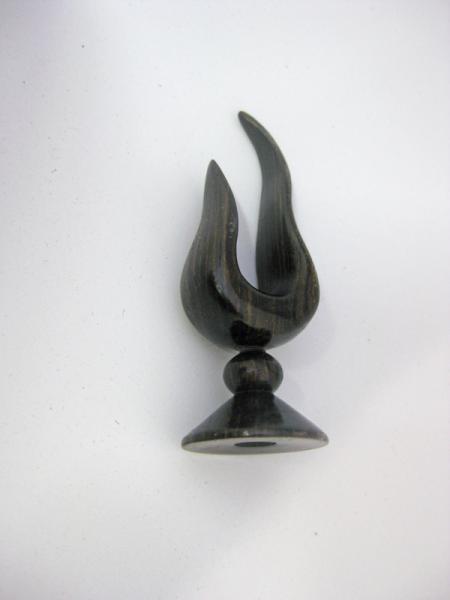

As I said, I turned it several weeks ago, but I couldn't figure out what kind of finial I wanted to put on top. After some discussion on another forum about a piece somebody else turned, I got the idea for this finial loosely based on a crab claw. The collar and finial are African blackwood.
The body of the piece is a little over 5 inches in diameter, and it's finished with gloss WOP.
Comments and criticism appreciated.

Fantastic job all around. I especially like the finial. I want to try one of these sculpted finials sometime.
