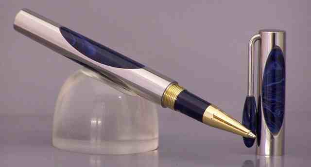

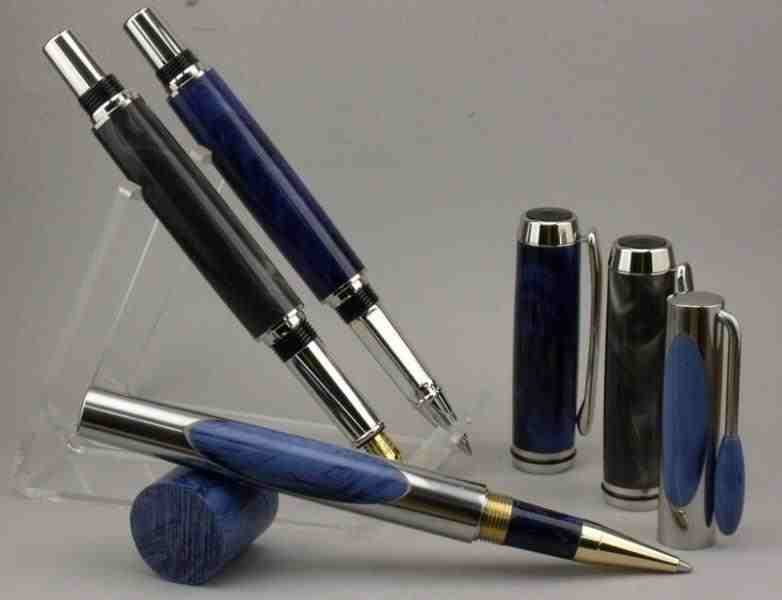

In this thread of a while back, I posted a pic of some pens with blanks made from bowling balls. I don't recall anyone else having the same issues.
The custom pen in the first pic had nice vibrant blue colours with swirls etc, but some time later the colour faded. This must have been from the light as the section above the nib remained vivid. The pen was in a glass display cabinet with the cap on, hence the nib end staying darker.
I can only assume that as bowling balls are made to be used indoors, that they don't bother to include any UV inhibitor in the resin. The other two pens are also made with BB blanks. But 90% of all the pens I make get made, pic taken then dropped in a drawer, so I don't know if the others would have faded.
