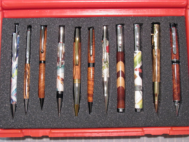

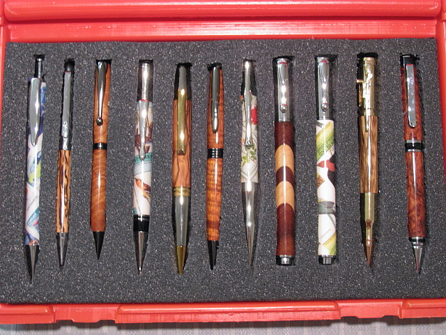

I used the thick foam organizer sheet kit that Sears sells. ( part number is 65417 with a 9 with a line under it before the part #)
I have had ca-finished pens in it a long time and no problems.
Steve
Comes with 2 sheets and a white adhesive-backed paper that you can draw out your design,stick it on,then trim it with the nice razor knife that comes in the kit,then pull off the tracing paper.
Here's how my case turned out..
