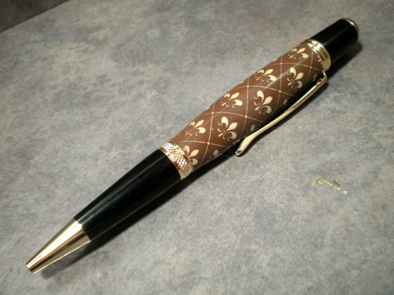

I just finished this up. Fleur-De-Cav from Creative Dimensions. There are sooooooo many possibilities with these blanks. Hopefully I'll be able to save up and order some more.

That is absolutely beautiful! Those 3-D blanks are, imo, the most innovative thing since sliced bread!

Nice job, James! I've been waiting to see who would post one first! :biggrin:

It finished pretty well. I used the same paint or similar that Charlie used....... folk art stuff something like that I grabbed from some projects the kids were working on. Painted the blank a solid color then wiped the excess off. I then let it dry for a few days. I lightly and do mean lightly sanded the paint off the high spots. I was a tad bit worried about destroying it. I probably would have invented new words if I had. I used CA for finish. Several glopping coats of med CA to begin with after filling everything in, I lightly sanded the CA smooth and added 6 coats of thin CA. MM to 12000 and polished.
And no I didn't apply the CA with a caulking gun. LOL. I used a t-shirt material and put on about double the amount of what I normally would. Seemed to go on really smooth. But I was being cautious.
I got some other ideas floating around that I'd like to try with them. I think you 2 came up with a very innovative idea. The possibilities appear to be endless. It gives the pen maker the opportunity to make creative one of a kind blanks. It shouldn't be overwhelming for people to make. I consider myself a beginner, so anybody can do these blanks.
