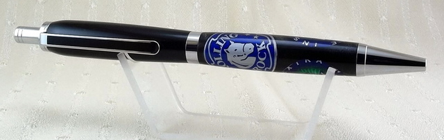

I tried several ways.
For this one I used a 7/8' hole saw and countersunk into a block of wood then
glued the cap face up and drilled it thru. When the bit had cut thru it helped spin the plastic off the back of the cap.
Then I dressed the edges a bit and formed around a piece of metal dowel.
Sometimes getting the plastic back off can be a pain.
Have fun
RR
Have fun
RR
Can you please clearify this? Did you drill thru the bottlecap?
