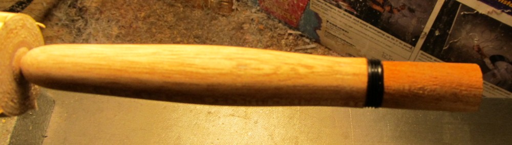

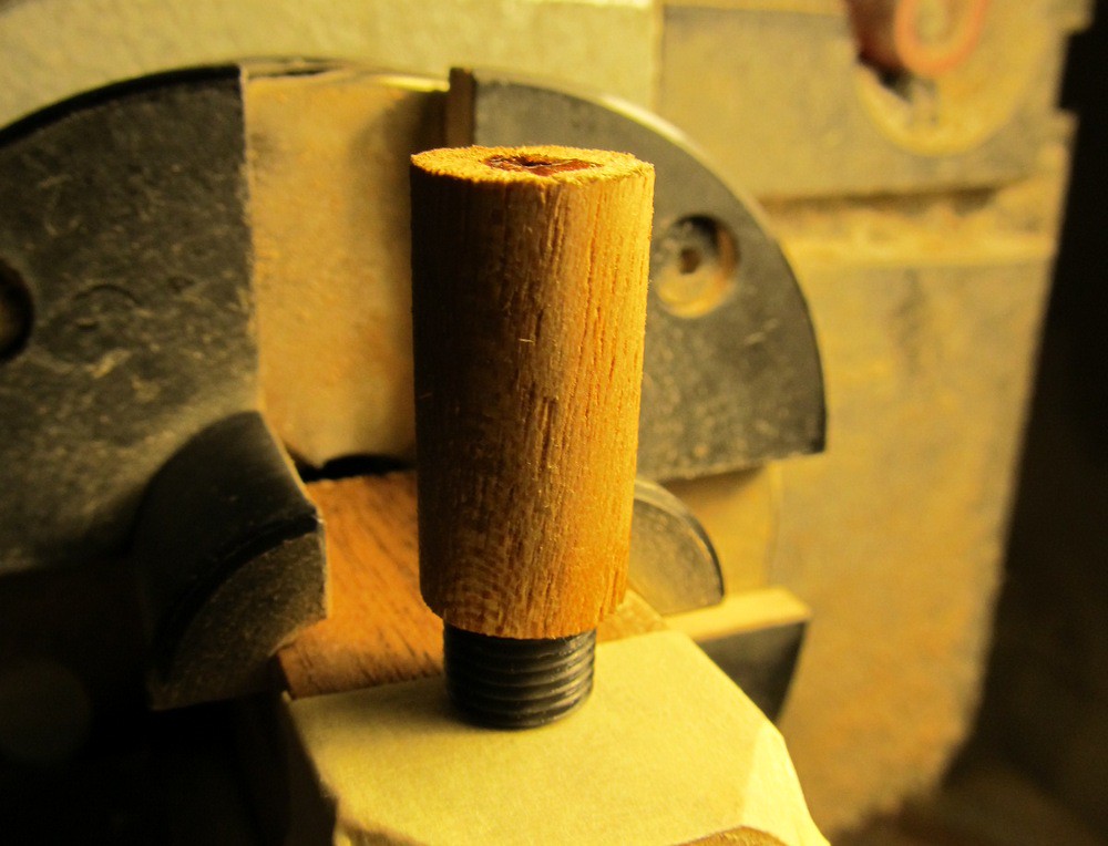

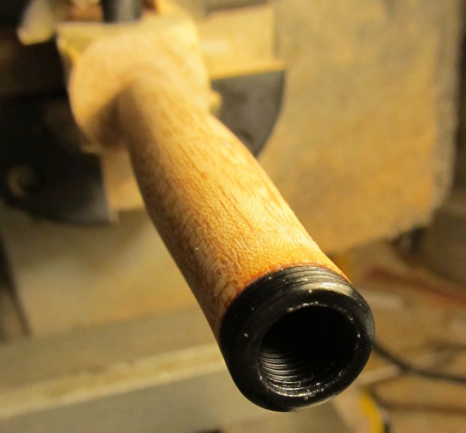

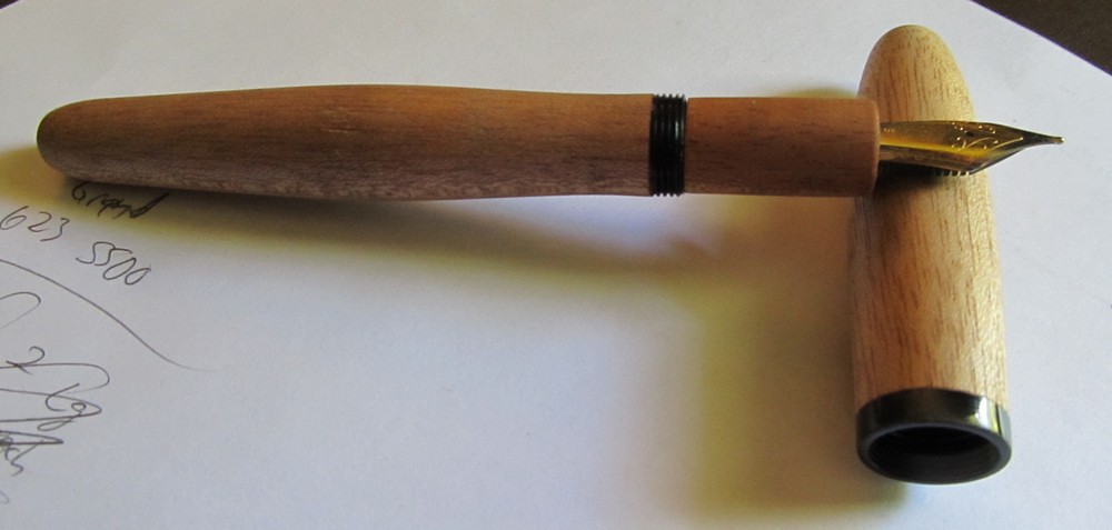

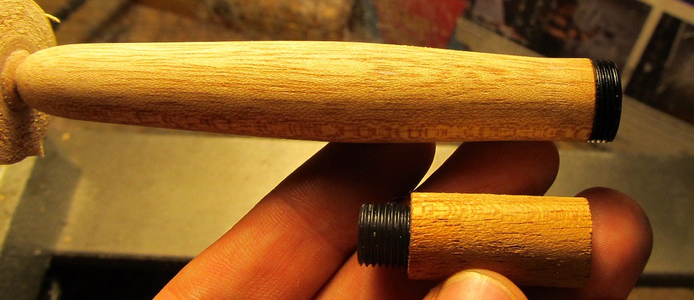

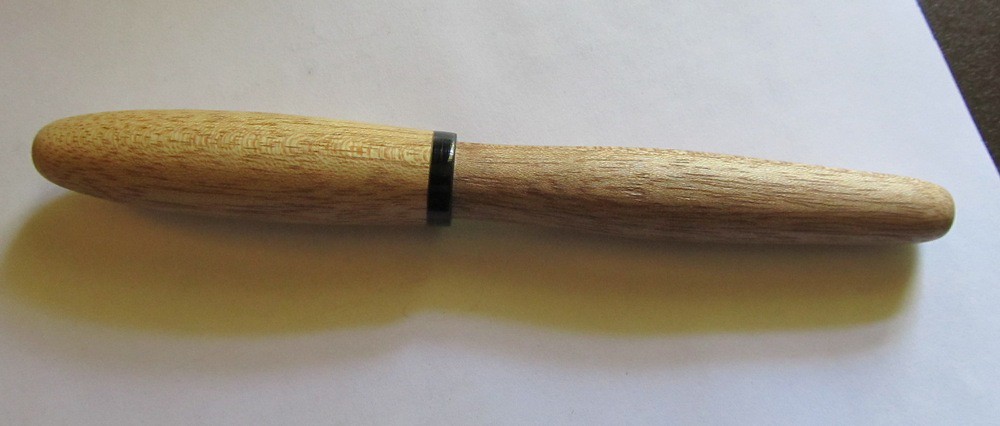

People have been asking for wooden pens. Here's a start.
About 5 coats of clear on the barrel. Not nearly done yet, though.
Threads at barrel to cap are 9/16" x 28tpi.
Threads from section into barrel are 10mm x 1mm pitch. Something like 24tpi?
002 by snennewton, on Flickr
001 by snennewton, on Flickr
003 by snennewton, on Flickr
004 by snennewton, on Flickr

One of my students has this one. He's been sort of prototype testing it. I've learned since he's owned it that I need to make the inserts for the cap fill the whole cap. Ink has dripped into his cap and stained the outside of the cap blue. :) He doesn't mind, but a paying customer might.
I'll look for some filler this weekend or so.
