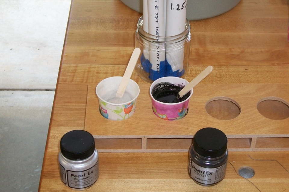

1. My setup when mixing. One cup with Pearl White, one with Carbon Black. This was the second cup of white, since the first one had kicked so quick. The black was still quite liquid, so I added a few extra drops of MEKP to the white to kick it quicker. White wasn't as thick as I thought it should be when black started to kick, but I poured both anyway.

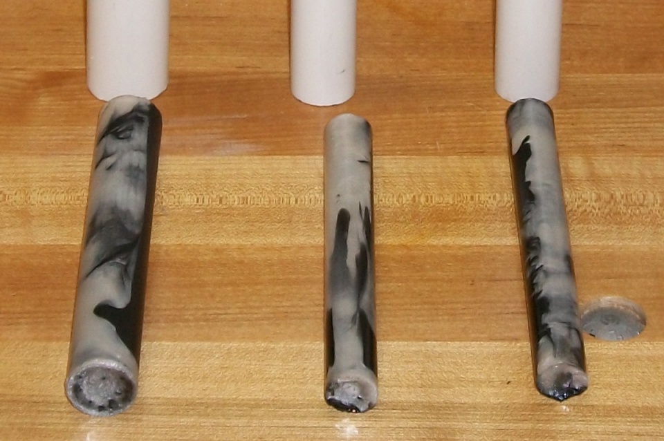

2. These are the resultant casts: one from a 3/4" mold, the other two from 1/2". I'll give it a couple of days to harden fully, then cut into them to see what I got.

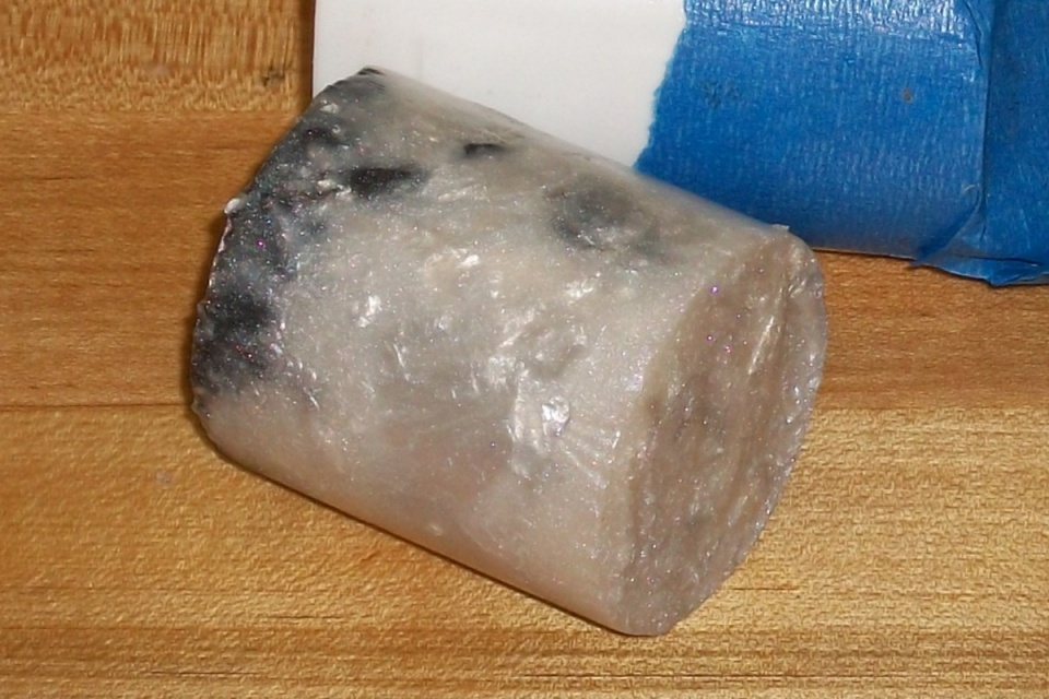

3. This is the white that kicked suddenly. As I said earlier in this thread, I quickly dumped it into a 1.5" mold to use as a bottle stopper. I added some of the leftover white/black to it to build its height a bit more.

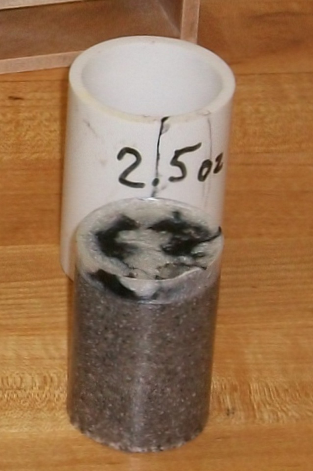

4. Before I worked with the black and white, I had mixed up some granite powder to make a bottle stopper blank. There was a little space left in the mold after the granite had kicked, so I added some of the leftover black/white mix.
