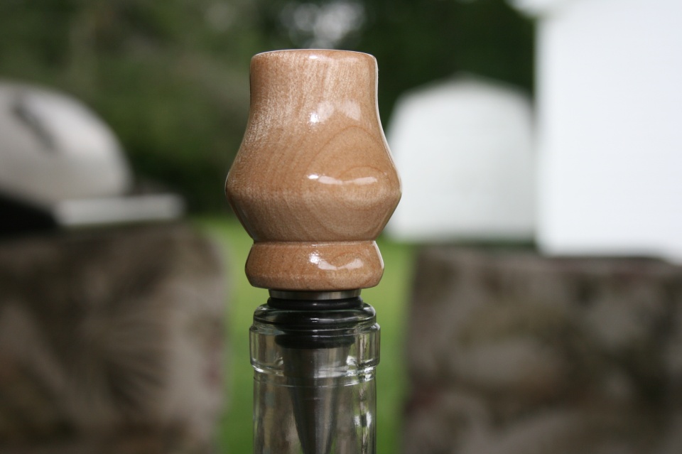

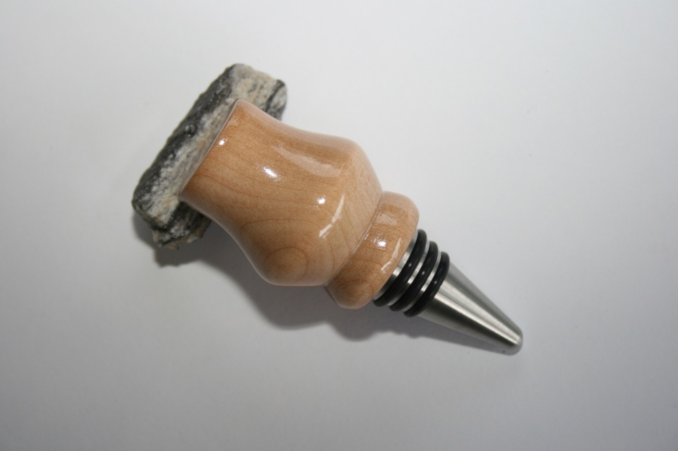

Here is my first bottle stopper. I ordered the kit from Craig (clapiana) at chefwarekits.com. I used a maple blank that I had in the shop and one of the stainless steel stoppers that came in the kit. I drilled the blank then soaked the hole in thin CA, once it was dry I taped the hold. I sanded the finished blank to 12000 mm and finished with WTF. I'm pretty happy with the look. All C&C are welcome. Thanks for looking.

That's a nice one. And you did a good job on the top. Many people do a decretive top that's pointed. Although it looks good, people that use bottle stoppers prefer a flatter or smoother rounded top so they can push it in with the palm of their hand. Or gently hit it with their hand to seat the stopper. But they are a lot of fun to make.
I learned that when I made one as a gift for a friend. He told me it looked good, but he didn't use it because of the point.

Thank you so much Bob and Fay for the nice comments. Bob, it funny that you mentioned the pointed top because I was thinking the same thing when I was looking at some of the stoppers I saw on line. Fay, there are a lot of stopper kits to choose from. This is the kit I ordered http://www.chefwarekits.com/ss-nile...set-11pc-woodworking-kit-made-in-the-usa.html. I also ordered this so I could drill and tap the blanks. http://www.chefwarekits.com/bottle-stopper-drill-and-tap-combo-set-heavy-duty.html. See the pens you have made I'm sure you would do a good job with a stopper. The kaleidescope egg are a lot of fun as well. I got my kits from Woodcraft.

Thanks a lot Charlie and Susan for your nice comments, I'm still working on the best way to sand when I have more coves and beads in a small area, right how I'm using 3" scalloped sanding disks, I'm thinking about air brushing WTF to see it that will make finishing easier. Any ideas on sanding and finishing are welcome.

The stopper looks great! I like the idea of the flat top. I'll keep that in mind for my next one (which will go on a SS stopper).
What I'd like to know is how you got that level of sheen from WTF. Every time I use the stuff, the piece comes out about as glossy as a post-it note.

beautiful!! I have really only used ca for finishing because of the forgivness of it haha, i would like to figure out a matte finish of some sort tho. What kinda wood is that maple?

Good looking stopper Dan. I am assuming you didn't put a coin or anything in the top. I like to do that for a little visual interest. Stick with the food grade SS stopper you used. Ruth Niles has them made in the U.S. and they don't corrode. I've had a ti gold stopper returned to me by my DIL all corroded. So now I am trying to find a 2006 Mexican coin to put in the replacement I am going to make. They were married in 2006 in Mexico so I figure it would be a fitting replacement.
