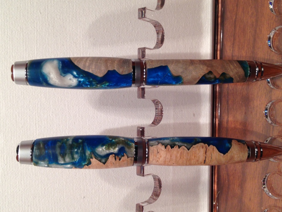

_DSC0053.jpg This pen was first dry sanded with mm to 12000 then finished with ca. and mm again to 12000. I feel the acrylic gets more depth when doing the mm before applying the ca then polishing again.

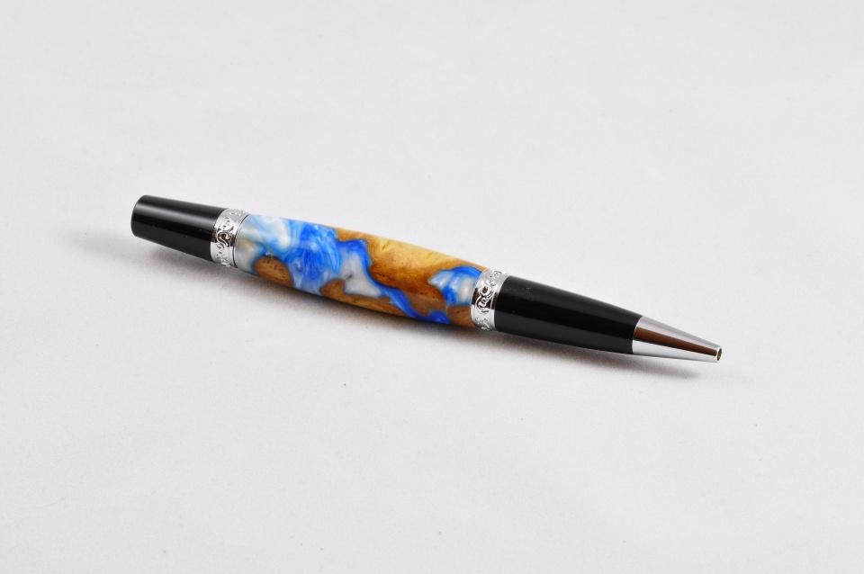

I am attaching a photo.
To answer some of the questions - yes I sand with the grain between grits; I use DNA to clean off the blanks before finishing; I do sand on the lathe.
I purchased another blank and tried it... the second one came out much better without the wet sanding.
Thanks again for the suggestions!
