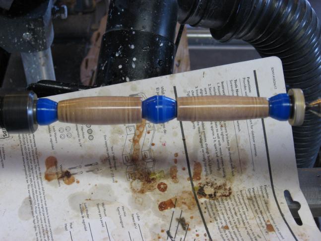

Steve; Dunk the delrin bushings in Actone to clean CA off them. Wax them before use and the mandrel too!. CA will not stick as much.
Also slimline pens are very forgiving as to length of the blank. You can trim the ends to remove any cracks or imperfections.

That is the way to make delrin bushings. Make them cone shape. Or you could set your blank between your live and dead center and put your finish on. If you build up too much CA on the ends then sand using the method shown.
