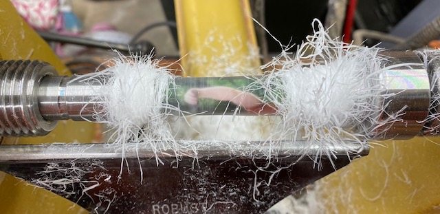

I started to turn the first Alumilite blank. The carbide EasyWood NR round cutter didn't seem to be very aggressive but I used it until the blank was round. I then switched to the skew and it seems to be slightly more aggressive but I'm new to this so maybe I wasn't putting enough pressure with the carbide cutter? I was cutting a little above center - maybe that was the issue?
The skew is doing it's job now but the thin hair it produces is really slowing me down not to mention at times it covers my view. There must be a way to clear these strings without shutting down and painfully pulling at them?

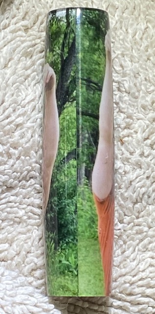

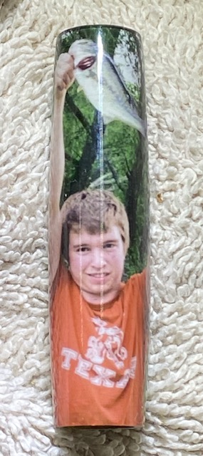

So I got over the "fuzz" and finished my first casting ever! I have 7 more to do so will assemble into the pen kits after they are all finished. I received lots of help here and other people willing to share there experience with me online. My wife and I couldn't be any more pleased with the end result! (these actually look much better in 3-D)

Great job on sizing and lining up the seam to be as invisible as possible. You should be proud!
as for the shaving, urethane resins are good for doing that such thing. Because the resin is so durable, so are the ribbons being cut. I've gotten used to clearing them out of the way. Even with the vacuum system on, they get caught up in the turning. I try to get them down to about 1/8" or less above the finished size before switching to then skew. That way there's less material to remove, leaving less ribbons to clear out of the way. Keep up the great work!

If you have an air compressor near by ive had good luck hitting the fuzz and strings with a quick blast of air.
