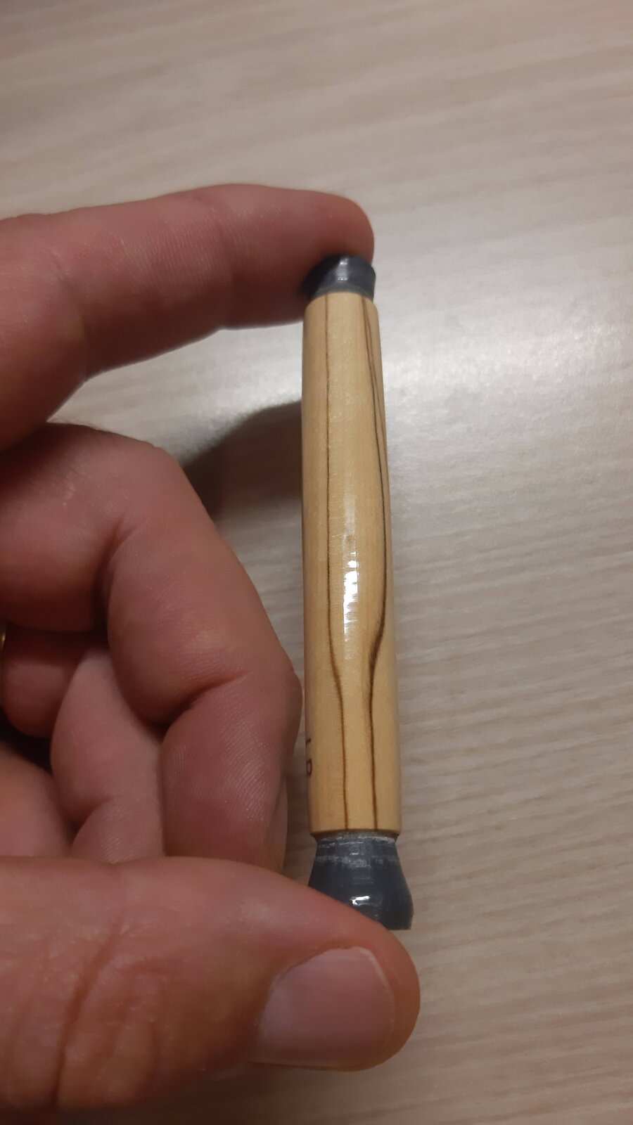

Recently I have noticed that after I finish wet sanding with MM up to 12000 I have circular patterns on my pens.
Any idea or suggestion on how to avoid that, it's really ruining the pen.
Thanks a lot.
