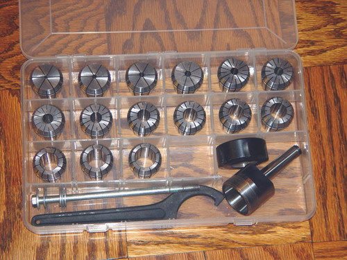

After seeing lots of conversation and questions on the different collet sets available, I thought I would add this. I bought this set a few weeks ago. #2MT ER40 holder with 15 collets from 1/8" to 1 inch. The whole set cost $89.99. Bought an 8" bolt from hardware store for the drawbolt and the setup is rock solid.
My 2¢.

e-Bay, but the seller mis-spelled collet so it was hidden.
"collects"
I am not paid for this referal or know the seller, but hope it helps fellow turners.
