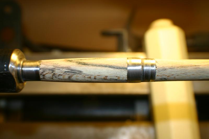

As you can see on the attached photo my end mill is chipping the wood on my blanks. It only does this on softer woods. It is good and sharp so how can I prevent this or what can I do to salvage a blank that this has happened to?

Are you using the mill in a drill press? You might be going to fast. I had a problem with uneven cuts and I fixed it by:
1) Getting a new 6 blade cutter head from Daniel.
2) Making sleeves that fit the barrels I was cutting.
3) Setting my drill press on its SLOWEST speed.
Can you provide a little more information on how you mill?
As for salvaging the blank, you could always try an "oops band." Cut off the end and add a piece of another wood, trying to make it look like you meant for it to happen. Or you could try to solve your milling problem and attempt to mill a bit more to straighten it out. This is a gamble because it may ruin the blank if it is too short to be used with the kit. Looks like a Euro kit from here, I might give it a shot if you don't like the "oops band" idea.
Good luck.

I am using the mill in a hand drill. THe kit is actually a CIGAR. I was thinking of CA and sawdust to fill but it would be a bit darker. Better than holes though. The mill as a 4 blade. I just got a 6 blade and it clogs up so fast I can barely get a thin shaving off the blank before I have to stop and dig out the clogs. I will give the thin CA a try.

to me, that looks more like the chipping is coming from turning instead of the end mill. i take the end mill to the blank before i even mount it on the mandrel.......those chips look like you have a dull lathe tool......IMHO

The texture on the surface (as seen in the photos) suggests pretty punky wood. Thin CA or white wood glue mixed 50/50 with water is probably needed to wick into the ends and firm them up. I like spalted woods, but many times they need help to be usable.

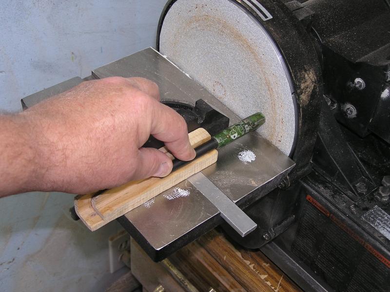

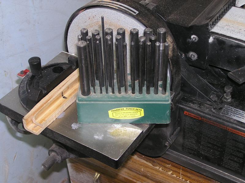

Get your self a set of Harbor Frieght transfer puches. No pen turn should be with out one. Use a bench top disk sander a trnsfer punch and a poece of corner molding. Problem solved you will probaly throw your pen mill away. Just be sure everything is square with your sander. See the photos below.
