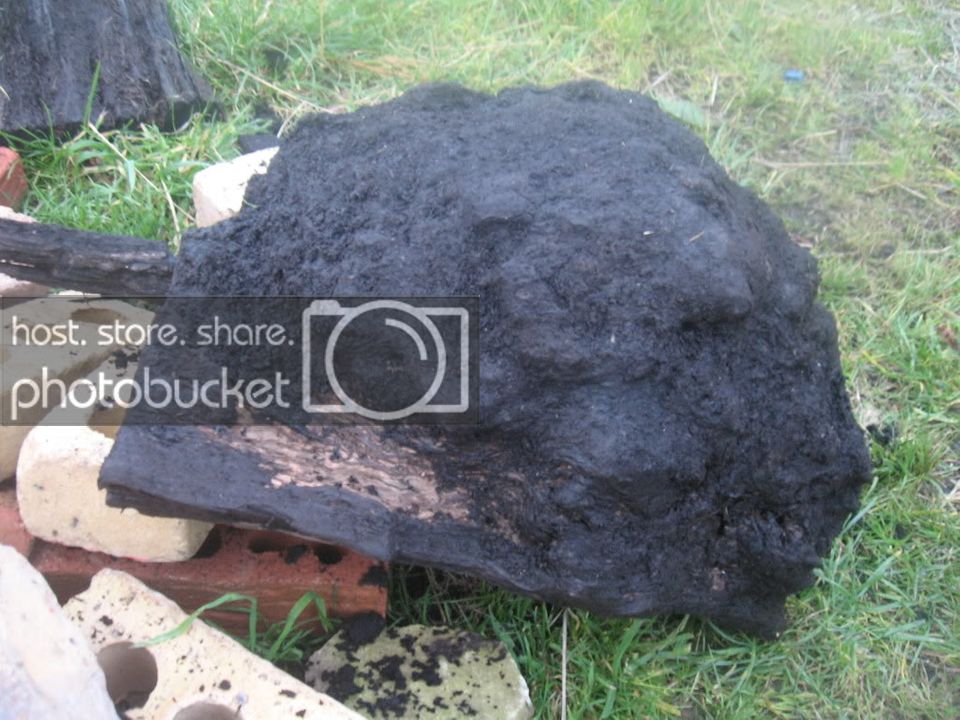

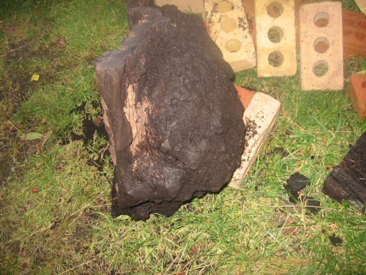

Need advice on drying oak burl, this is extremely wet, jet black and fresh from the bog :biggrin::biggrin:

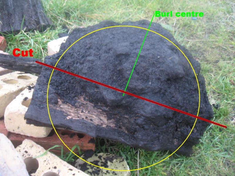

Best way to cut it (after clean of dirt) is, look at the part that was attached to the tree, as if it was the base (root) of a tree, cut it as if that was the direction of the grain, let it "bread" after so many years in its "cocoon".
Store it in a dry and dark place over some news paper for a little while, if you feel like using sealant, use it but only on 2 faces, not opposite faces but two that join at a corner, this as 2 effects, first still allow any excess moisture to come out, allowing it to bread, secondly keeps the pieces from twisting or bending in any particular direction, the 2 sealed faces basically "balance" the tendency the other two unsealed faces have to move.
This would be what I would do if that burl was mine, it will take no time (4 to 8 weeks) before you can start using it. Also remember that the smaller the size you cut it, the quickest it will be ready to work, so if you want to start making pens out of that burl, after you get your pieces at 2"1/2 square, slice one or two into pen size blanks, use the same sealant "principal" on the 2 faces if you wish (not necessary) if you are going to turn them soon. Another safe and efficient way to allow timber to dry and keep straight is to make a bundle with timber spacers in between (about 1/4" or so) and rap it very tight with wire or packing strap, don't use tape as it will block air to go in and it will get lose quick.
So in general, see your find as something that is only going to "shine" out of the cocoon, shaped and polished to your satisfaction, that will be your reward...!:wink::biggrin:

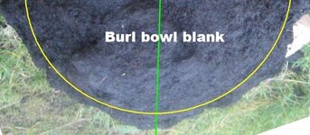

George, I was hoping to leave it as large as possible for a winged bowl or platter
Fair enough Keithkarl2007, that was always another possibility...!
In that case, and if the proportions are right based on the size of the bricks next to it, I would say that the burl is about 15" at is wider point, so you should have about 12" of clean cut, everything going right, and about 8" of depth. This will always be a one shot attempt, if you want to utilize most of the burl as a bowl so, it's worth a go, for sure.
I'm attaching your edited pic, with some drawings of how I would cut it for a bowl, it may help you...!

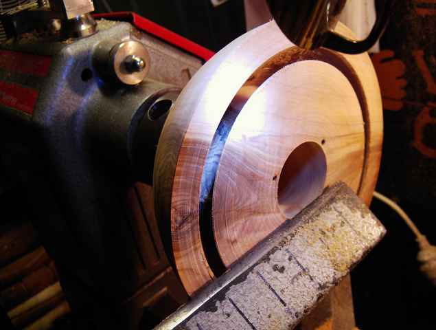

Another important thing is to try remove the bowl's "guts" before if will become shavings, you will be able to make either a smaller bowl or a few pen blanks, just to name a few! If you don't have a proper "bowl saving" cutter, is easy enough to do it with a good partition gauge (also pics attached).
Your type burl is no longer "green" but, you can process it as if it was, just to be on the safe side, this include the turning of the burl, with a more chances for success to rough turn it as you would normally do with green timber, leaving about 1" thickness all around to give you a safe margin to re-turn it later on.
I would certainly give it a couple of coats of a good timber stabilizer , as soon as it would come off the lathe, for safety and then put it a side to dry for a few weeks. Obviously, whatever the drying time I mention here is based on the principal that we have about 25C on average, so cooler locations will require a little more time, unless the timber is dried artificially!

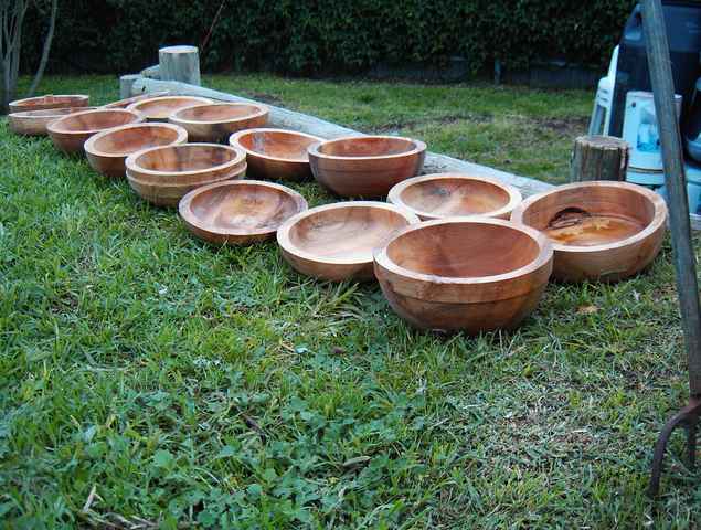

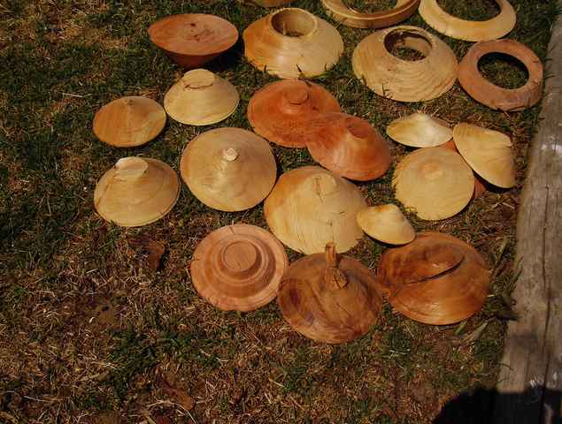

Don't do the mistake a friend of mine did, he loved Olive wood that much that the day he had the opportunity to get a large block from a olive butt/root, he got home and cleaned that root to almost perfection (you will never get all the dirt/stones/sand, etc.) and store it in the driest and safest place he had in his large shed. He would daily go to that shed to do stuff, mainly turning and other wood objects, and every day he looked at it and wished he could turn it.
Not long after we met, I visit him for a day of wood-turning (boys day, sort of thing...!) at his shed, and as I enter the shed, my eyes nearly come out of my sockets when I looked down under a large shelve and saw on top of a timber pallet, this humongous chunk of olive, that I calculate to be about 100kg+. After a few questions of what in a heck?, we admitted to me, and later on confirmed by his wife that, the olive root has been there "waiting" to dry for 25 years, yes twenty five years...!:eek:
This poor guy din't had a clue what to do with it when he got it, someone told him that olive wood take over 20 years to dry so, he just patiently waited and looked and waited everyday. He got to a point that the 20 years were due but, he completely got stressed out and panicking about the possibility to bugger the whole thing over, a few years before the time was over...! poor guy, he was so scared to touch it that, nearly every day, as he modestly admitted, he would awake up in the morning thinking, yeah, today is the day, have his breakfast and walk to his shed for his "adventure" but as soon as he would see it, he would just go the jelly and give up.
That same day, and after a table conversation back in the house with his wife at the same table over a nice coup of coffee, I convinced him to wait no longer and stop him feeling sick about it, in secrecy for all those years.
Fortunately for me, he had his work shop set-up beautifully, wasn't much he didn't had there in regards to tools and machinery to work with timber.
The rest is History really, I reckon he got a big load off his back and for the way I saw it, that weight was identical to the root, I'm sure!
I got a small piece of it as a special "momento" of the occasion, it still has been untouched since as a reminder...! I can also say that the number of pieces he turned out of that root, were enough to keep him in his dream world for nearly 6 months...!:biggrin:

It was in a puddle of water on the bog when i found it, don't know what made me turn it over but when i did i seen the burl. At the moment its still in the refuse bag

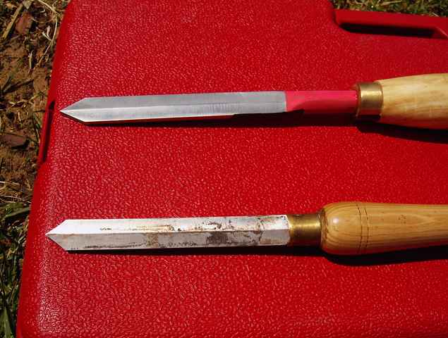

If you have a lathe to handle that size raw material, you should have no problems to cut/save the core of the bowl/burl material. As I shown on the pic before, you only need a partition tool, and if you don't have one, you could try to make one, more commonly known as "core knife". One of the most effective and easy to make, are the ones made out of a medium to large size circular saw tungsten used blade. You only need 1 x good tooth on the blade to make this tool, and it goes like this. Try to get a 250 to 300mm diameter used disc, put it flat on a table with the teeth pointing upwards, on your left side at 9 o'clock position, now using a ruler on a straight edge, mark a straight line from the tooth bottom gully, from left to right in a horizontal line, right to the other end on the right. Measure about 1" bellow that line on both ends and make another line, if the blade has many small teeth, don't worry, you only need the one you are using as the "pilot" for all the markings, and you can leave them there, they will not matter, but you can also cut them if you want! If the disc has left and right angled teeth, make sure the pilot tooth on the left, is a left tooth, there is, the pointy bit on the tungsten cutter, is pointing up and NOT on the bottom flat touching the table.
Now, the only thing you need is a handle, and for that the safest way is to get a piece about 1.5 x foot long (good handle length for this tool) of 1" steel rod, or even heavy duty round pipe, cut a (sandwich) groove about 1" to 1.5" long on it the same thickness of the circular saw blade, remove the teeth and cut the end of the knife that goes on the handle side, flat and weld it on the top and bottom, ONLY!
You can use tape or any other rubbery material to rap around the handle for gripping if you also wish, and voila, the core knife is ready to goo...!:biggrin:
There are many other ways to make this type of knife but they require a certain amount of expertize to get the shape and the sharpening end done right, so lets keep it simple, for now...!:eek::wink:

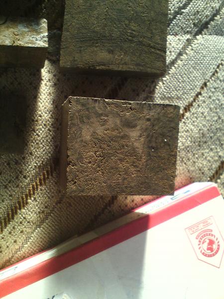

I haven't shown any progress on this since I found it but i cut some of it up today from the smaller burl.

Keith was it starting to dry?? I don't suppose you have a moisture meter do you? If you of a mind to sell a few pieces let me know, I'd be willing to buy a few from you.
keithkarl2007
Apr 22, 2008
1,727
Ireland
These pieces along with a few other pieces are dry. I won't be selling any for a week or two. I sent some to a friend on the forum so when he posts a finished pen I'll offer a few pieces.
