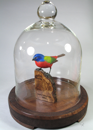

This is something new for me. I don't do much faceplate turning but when a friend asked me if I could help him with a display base for his daughter as a Christmas gift I jumped on the chance (sort of).
He supplied a 12" square, 2" thick piece of walnut and a
9" diameter glass bell jar.
Having never designed anything like this before, the task was a little daunting. A wanted something a little classy but not overpowering, after all the carving will be the star attraction.
This is what I came up with.
The final dimensions ended up being 11-3/4" diameter and 2" thick. I stuck the bell jar on it and placed one of my old carvings in it for demonstration purposes.
I still prefer spindle turning (don't much like that heavy disk flopping around on the lathe) but this was a fun project. Here's hoping he likes it.
Any comments or criticisms are welcome. Thanks for looking.

How do you get that bird to sit still in the bell jar?:confused::rolleyes:
Probably glued it's feet to the base then when it ran out of air it couldn't fall over.
Turned out very nice Larry. I don't think there's any fear of you having to send it to Mack.
As least he didn't glue it's mouth shut!! :eek: :wink: :biggrin:

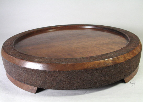

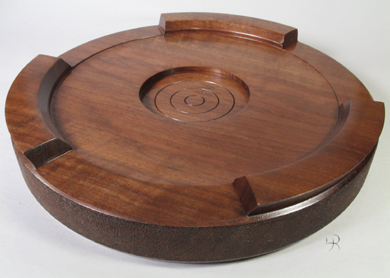

Very nicely done Larry. How did you do the feet?
Dec 17, 2008
286
Canada
Carved Feet
Jamie, the feet were all done with hand tools. I laid them out on the lathe at 60 degree intervals, cut the ends with my dovetail saw at an eyeballed angle (probably close to a dovetail angle) and removed the wood between the cuts with a #2-1/2 carving gouge. A little sanding and all done.
View of underside of the base. Thanks everyone for your comments.
