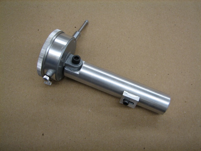

If you make your own holder I suggest you get an indicator with a lug back, here's a pic of mine...
I hope this gives you an idea for making your own.

Thank you, I'll was thinking in holding it by the shaft, what do you think?
I think you should get one like Rick has in his photo. Gripping by the shaft could squeeze it and interfere with the mechanism.
They usually cost less than the one you found on Amazon. Such as:

.....Gripping by the shaft could squeeze it and interfere with the mechanism.....
I'll have to disagree with you on this one. Indicators are made to be gripped by the stem and lots of measuring tools use that method to hold dial indicators. Dial Depth Gauges and Bore Gauges to name two. You have to be a real graunch artist to crush the metal enough to start interfering with the plunger action. There are lots of tools that use set screws, clamps and collets to grip the stem so there is no reason Michael can't do the same. It might still be easier to make a tool to hold the lug or a dovetail back but that's for him to decide depending upon his abilities and stuff he has to work with.
Thanks Pete - I'll take your word on this. I've never done it (out of concern that it might damage the stem), I tend towards caution.
Hello, thank you. Yesterday I saw lots of videos of people using the dial indicator and everybody hold it from the shaft. I was about to give up but after your answer I feel more confident. Thank you so much.
