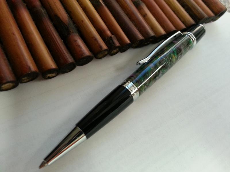

Guys, Today after destroying the 5th blank in a row, I was ready to throw the lathe onto the concrete to see how many pieces it would break into. One I cut too deep in the middle. another had the wood crack, another had chips on the end of the barrel where it would meet the cap, the hole doesnt go straight through the blank on my drill press. I go to trim the ends and a huge chip breaks off exposing the brass barrel. And many more issues.
I bought a used Grizzly MT 1 lathe, a new mt 1 mandrel, now bent, and I use a hand drill with a barrel trimmer to trim up the ends before placing them on the lathe. I have the carbide tipped tools, one round and one square. I use a used craftsman drill press I got at a garage sale.
Thing is I really want to get good at this. I attached a picture of one pen I did to show that I can do it. I have made about 15 succesfully and those my wife uses at work have had people ask her if they sell them in the store she works in. But, for some reason a simple letter opener is about to make me give it up. My wife thinks its just the equipment I am using, I am just frustrated that for two weeks I have produced nothing but saw dust. Any body have any advice???
