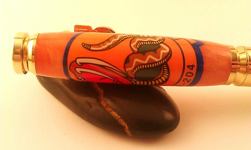

I have only made a few, but I put the stickers directly on the tube, then cast the entire thing in clear PR. Here's the result:

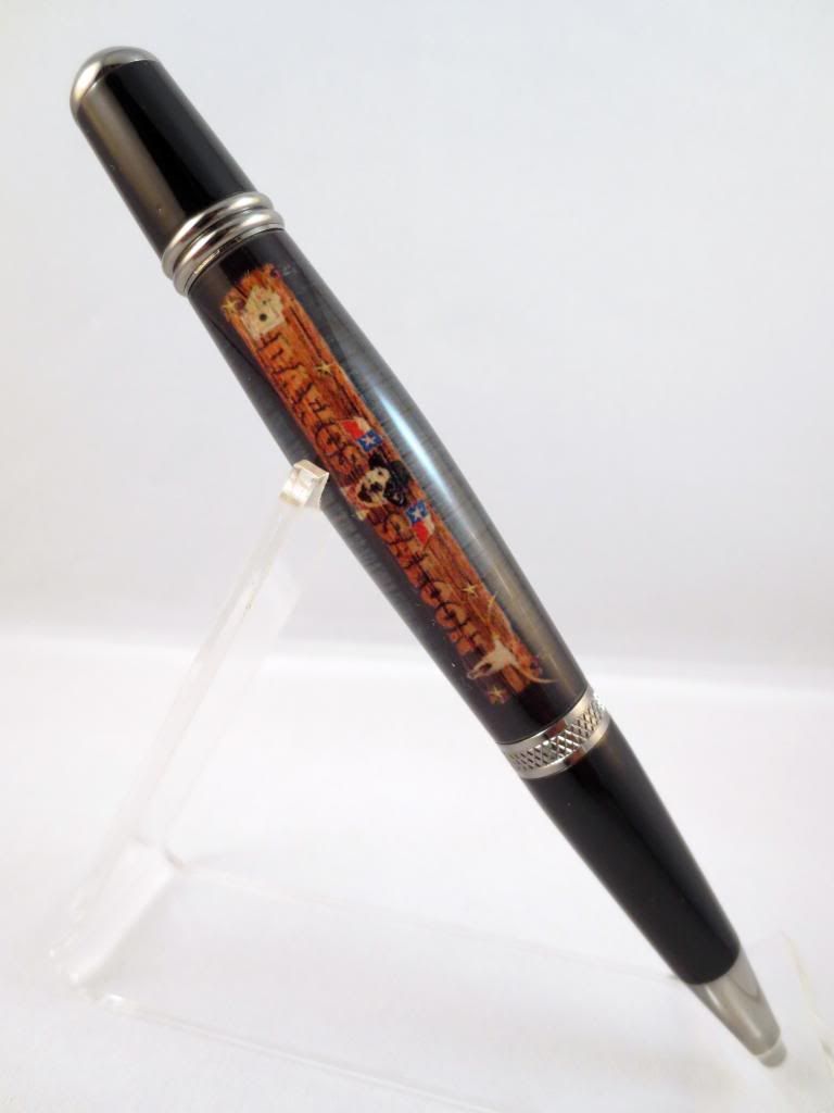

I use stickers quite a bit on some of my pens. My process is as follows:
- Turn and sand blank down to 400 grit . 005 below bushing size and as straight as possible (no curve in the blank).
- Clean blank with CA activator. (I'm sure DNA works too).
- Apply sticker with no folds. Take extra time to get sticker on there flat.
- Put on Delrin bushings.
- Apply 3 coats of thin CA, then 24 coats of medium CA.
- Dress ends of your blank. (I use sand paper instead of barrel trimmer).
- Carefully sand excess back to final bushing size up to 600 grit.
- Buff with Tripoli and white diamond.
- Admire your hard work.
This is my process. I'm sure you will get many more. Hope this helps.
