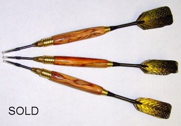

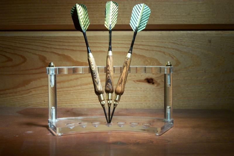

I have to build another light box (my dogs ate the cardboard box I built). So here's a crappy cell pic of a dart I turned this week.
I learned that the short tubes can only be stuffed with 8g of lead wool. Jon suggested trying lead fishing weights, packed in the wool. I'll give it a try. These were maxed out at 18g; I prefer 22g in mine.
Stabilized and dyed buckeye burl (that I got from Jon). 10 coats of CA, sanded through MM twice, Plastx polish.
Does anybody here turn them? Any hints or tips or advice? I hope to/plan on selling them.

It was a cake walk. The PSI kit uses SlimLine tubes (roughly the same length) and 7mm SlimLine bushings. The lead wool that comes with the kit isn't enough to make them as heavy as I like; but the tubes aren't long enough to pack enough in them to make them heavy enough.
PSI also sells a scale that makes weighing them easy; just clip the scale's storage bag to it, note its weight, then put the components in it, then subtract the weight of the bag to get the weight of the dart.

So far I like them a lot. I've only spent about 20 minutes playing with them, though.
If your friends are snobs, it doesn't get much more high-brow than hand-made! Think about it...no two are identical unless you make them from solid-cast resin.

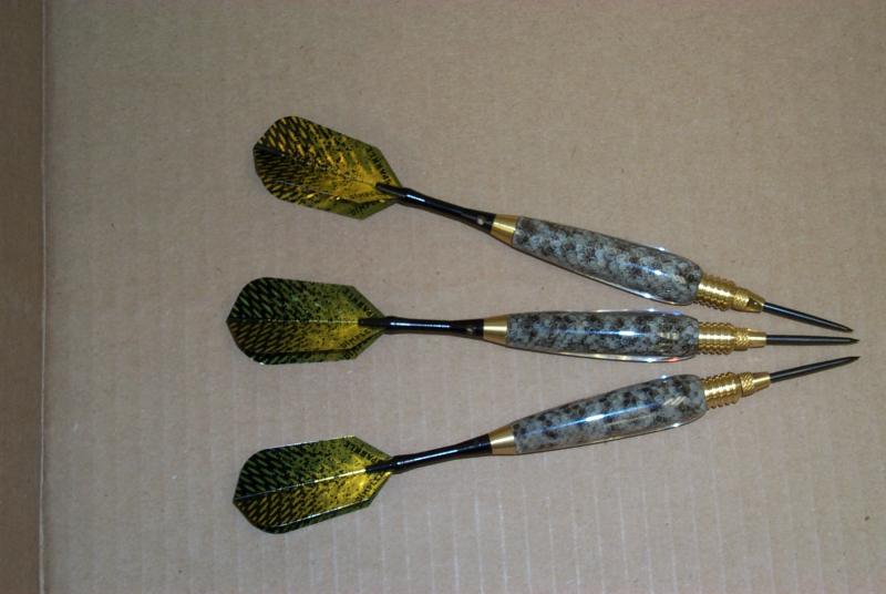

Here's a much better pic of them; I set up a new light box today:

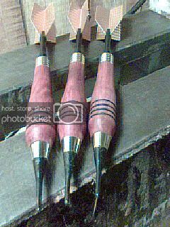

I have made several sets. Will try and post pics later today. I have cast snake skin in the and they were really cool. They were pretty much a custom deal. Some like to have them head weighted. and others like the weight further back. Also some like different weights. I work where I have a VERY sensitive digital scale and get the weights as close as possibile. Usually within .001 of each other. Remember weigh all parts. including the flights to get the proper weight. I only wish Someone sold a nice lined box for them.:)

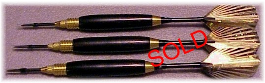

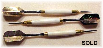

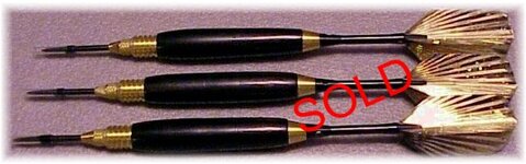

I've turned a few, none lately though... I didn't have any trouble packing the tubes with the lead wool though... I made one set from antler, forgot the wool... luckily the whole set all weighed out at just over 19 grams each...
I don't have any tips or tricks to offer though... they are pretty straight forward turning, much like the slimlines... matter of fact, I think the tubes are the same 7mm as the slimline tubes... here are a few of the ones I've turned.. Ebony, Antler, cocobolo.
Please overlook the crappy photos... I'm much better on a lathe with a skew than I am with a lightbox and camera.

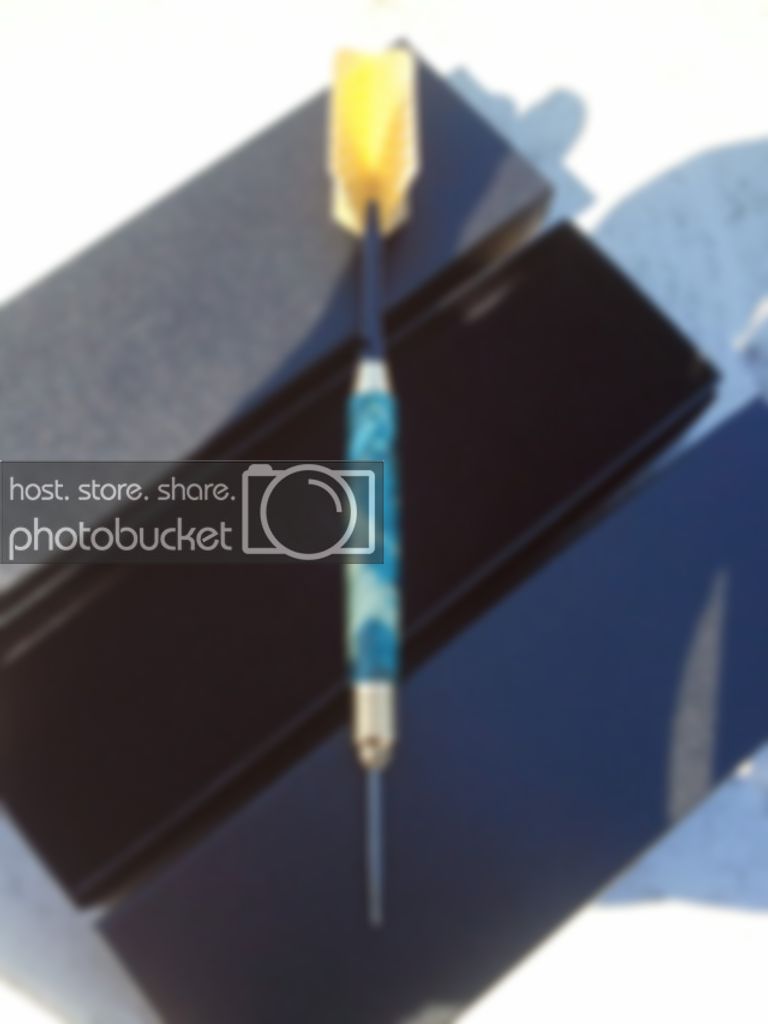

Here are two sets. I made. The snake was cast diamond rattler and then turned and polished. Still wish they sold a box for these.:wink:
