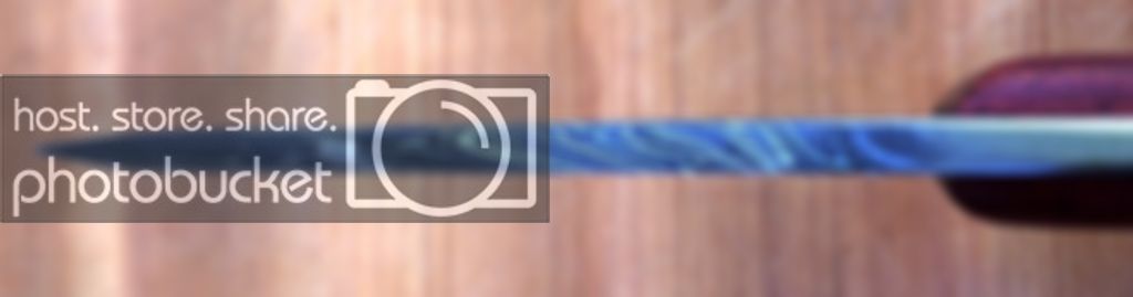

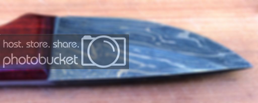

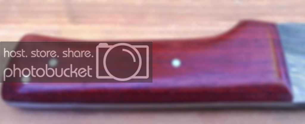

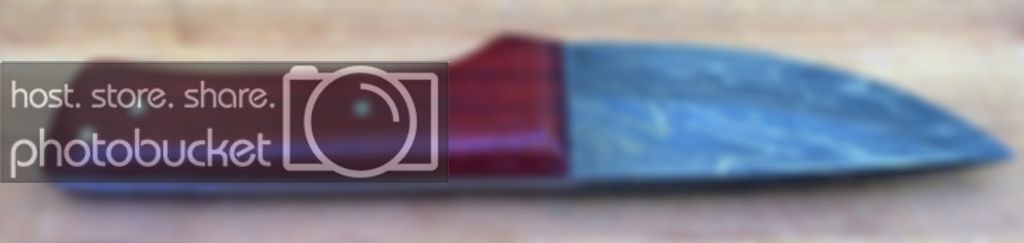

I made another one for a friend
I purchased the blade from eBay and my friend selected deep red bloodwood. Here are the results.
I finished with walnut oil using MM pads through the stack. A little pens plus finished the effort. It feels amazing to me. It used a Worksharp knife sharpener to make it scarey sharp.

A drill motor, bit, pins, clamps and the saw you already have are needed at start. I used an oscillating spindle sander, but a belt sander would be great. I used HF 5 minute epoxy and clamped thoroughly to be sure there were no gaps between the scales and the blade.
Great tactile rewards as you move from 180-400 grit and then migrate to MM and oil. It was a nice change from pens and plugs.
