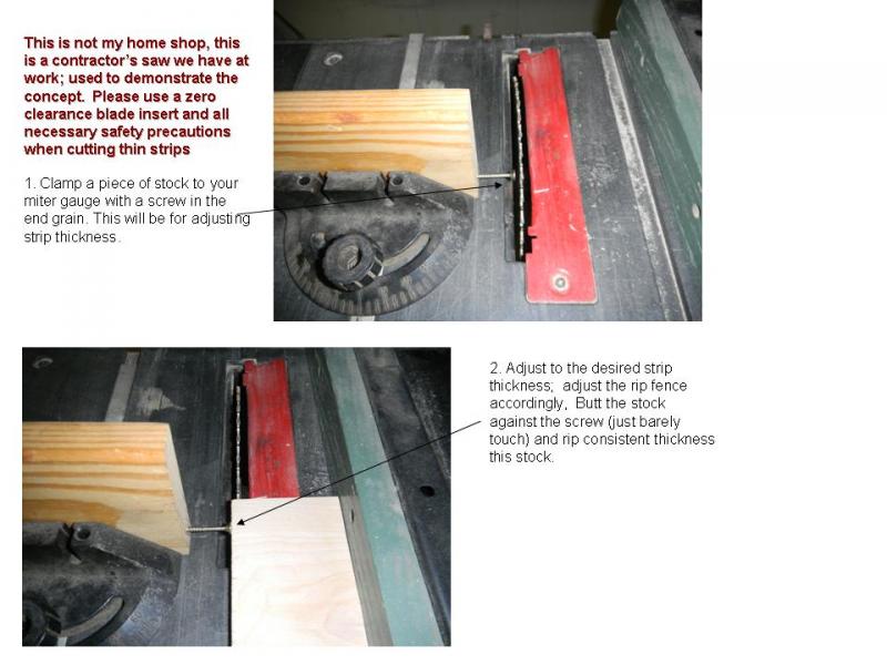

LL Woodworks
May 4, 2011
638
North Texas
Cutting thin strips
Here is the method I use a lot. Note I shot this quick on a contractors saw at work. Please use a zero clearance blade insert and proper safety precautions when using this method. I works real well, I've cut maple strips as thin as 1/32"; Depends on the quality of your fence system, miter gauge / slot and saw blade. Hope it helps
