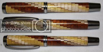

Thanks for the replies. The woodcraft saw is a little too small. My blank is slightly larger than 1" square. I do have a sled for my table saw, but I use it for bigger stuff. I don't like to cut any small items on table saw. I do not want to use my table saw. Even if I put a thin kerf blade in it, I will still lose more material than I want to. I have a blank, glued up, that is about 5-7/8" long, if I cut that up, I will not enough blank for a cigar pen.
The type of segmented pen I am making is like this:

I have started to move into segmented pens and would like to make some DLGunn posted.I have started with the 30 degree Herring bone and am happy with my journey so far, but...
Maybe my technique with a skew is not perfect so I have tried sanding them but always end up with muddy looking light wood. I am trying to leave CA and use enduro which I have found when dipped for 3-4 coats looks very acceptable and I don't require a respirator and am able to continue working in my 1 car shop.
Am I correct in assuming I cannot sand the pens with multi-colored woods?
