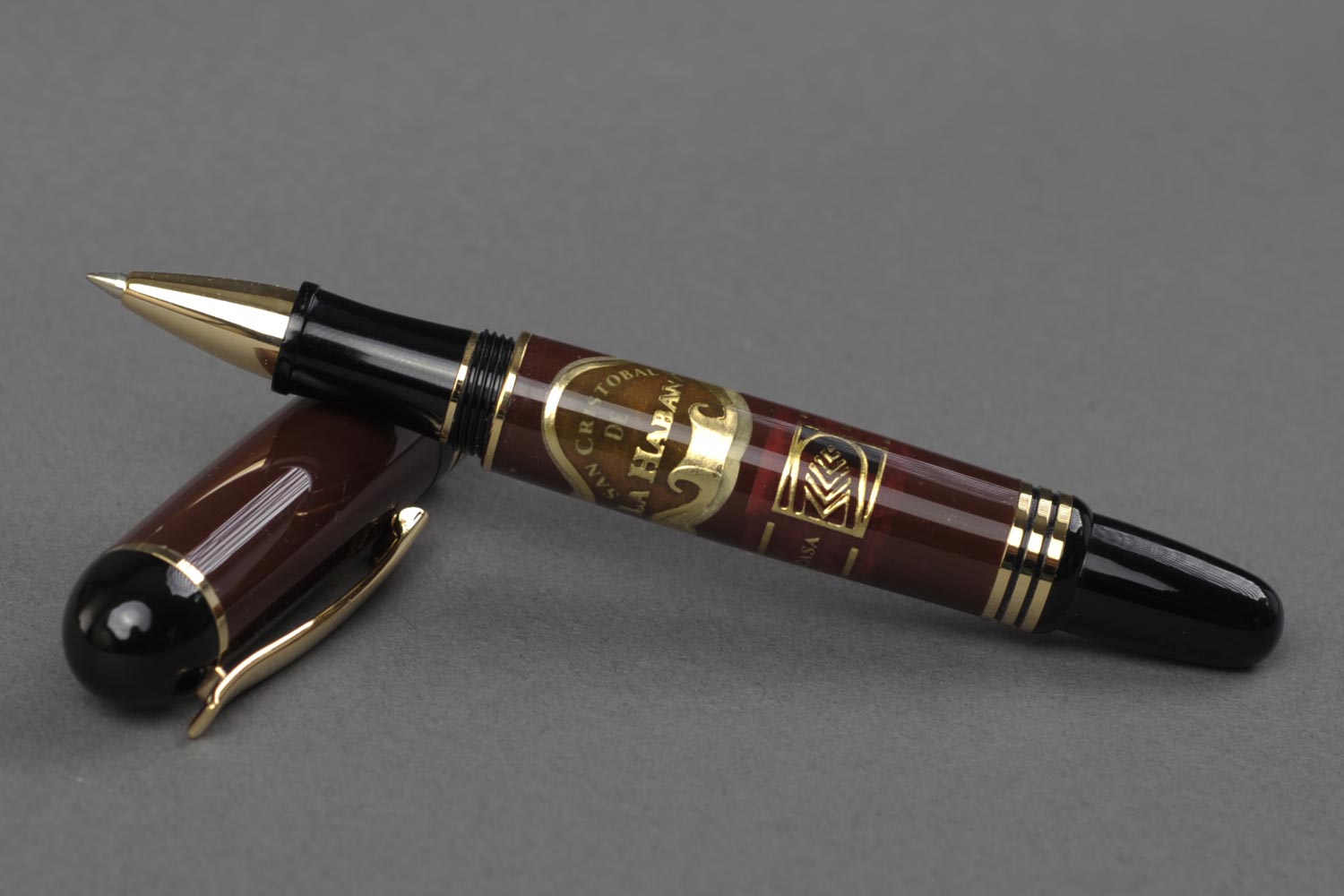

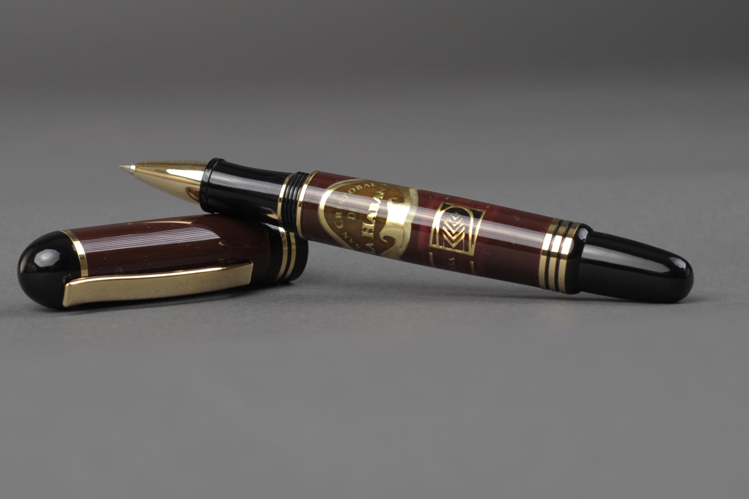

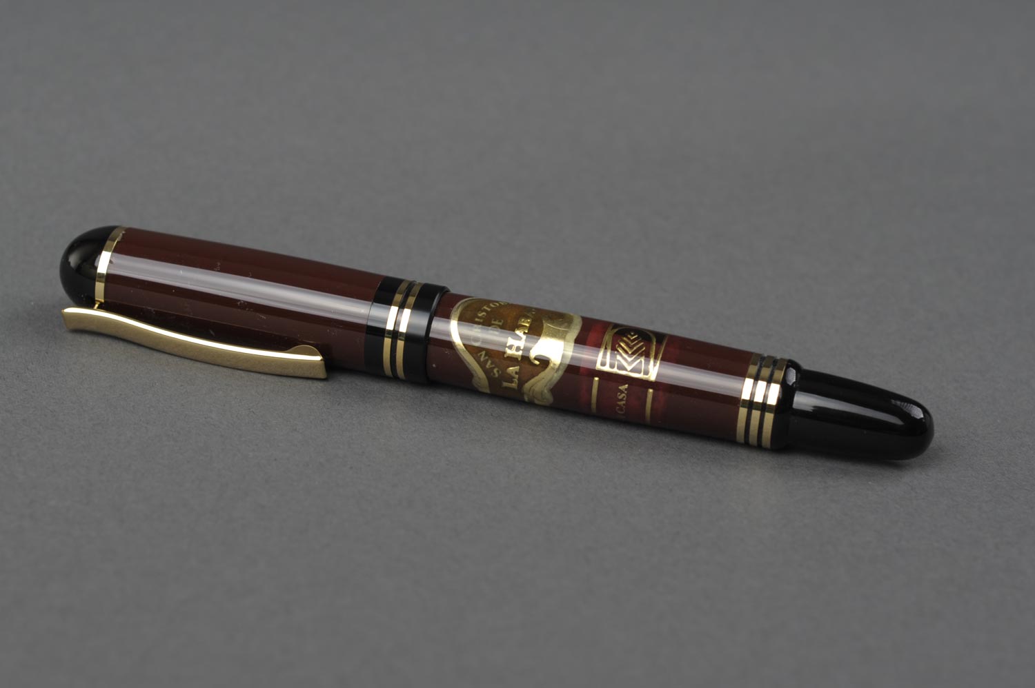

So here was my first attempt at embedding an object in PR. I have a lot of work to do but though I would show the group anyhow.
I need to find a way to stop the PR from soaking into the cigar label and making it look wet. I think next time once I get the bands glued on I will run a think layer of CA over the whole label and painted tube to seal it so that the PR won't be able to soak in to the label.
Thanks for looking

Nice man, that band goes great with the kit.

Very impressive pen, Jonathan! The picture doesn't indicate any soaking of the label, at least on my screen, but I'm sure it may appear different in the hands, rather than on the monitor. Good job!

That's a great pen, like others have said I cant tell from the picture the label looks wet, and you did it on one of my favorite kits, it just looks like a very high class piece of work.

Love the color match to the label.
Is it paint or powder coating?
Can you expand on what you think the problem with the label is, soaking of the label? It doesn't look like it seperated or released from the tube.

The tubes are simply painted with brown acrylic paint. I guess you can't really see it in the pictures but around the edges of the bands it looks like the band is wet where the PR leached into the band. This was a learning experience, the next one will be much improved.

If you're going to cast it, you could paint a leaf on the tube, glue down a band, then cast it in clear. It should give the illusion that the whole blank looks to be shaped like the leaf.

I have lots of whole Cuban cigar leaf intact. I'm waiting to get my pot setup so that I can try to cast leaf right onto the tube then I wont have to paint them at all.
I'm horrible at drawing so painting a leaf on is out of the question for me. :)

Neat 'cigar' band pen. I do believe you did a great job as this is your first attempt with the band. Be sure to tell us how you improved on the label problem you think you are having. :)

I actually encountered this wetting of the label you speak of. I tried a couple of things and the thing I remember that worked best was a thread color preserver from my fishing rod building days. It is kid of like watered white glue. It sealed the paper so the resin didn't wet it. Another thing I experimented with and got good results I think I was using fabric. Was 3M Scotch guard. Something to try.
