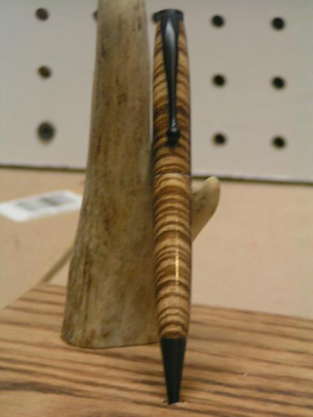

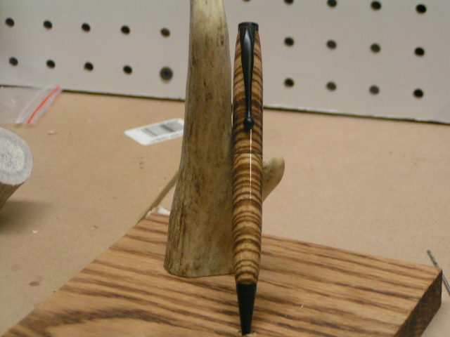

Cross Cut Zebra Wood.
See more from USAFVET98
USAFVET98
Aug 5, 2008
1,282
Hawley, Pennsylvania
The picture isnt great, but I worked hard on this one.
Comments are appreciated as always.
USAFVET98
Aug 5, 2008
1,282
Very cool. Did you cross cut the blanks? I am not sure I have ever seen a piece big enough to cross cut.
Yes, I cross cut them. I have a few wide pieces laying around. I was very hard to turn though. I broke 2 halfs before actually getting it. It was harder than the cross cut red palm.

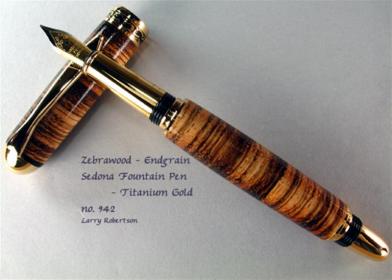

Here's one a friend of mine turned. He says the secret is to drench it in CA when you get close to finish size.
