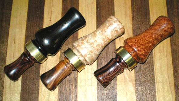

Made these today after filling up the pressure pots with carbon fiber blanks. Left to right is Ebony, Birdseye Maple, and Curly Narra. All the tone boards are Cocobolo. I have a jig for the toneboard and make my own, and have found that Cocobolo sounds about the best overall. I gave up on duck calls for a while because cutting the reed consistently the same to get good sound was a real pain. The light flickered in my brain and then came on the other day. Laser, duh. I spent some time testing and now have a shape and size saved in the programs and have a box of identical reeds that sound pretty good, IMHO. All comments appreciated.

They look great. Have you tried one with out of all cocobolo? I have several cocobolo metal reed calls I use when hunting open water. Man are they loud.

George. I made one all Cocobolo call last week and it sold already. It sounded like these. I use mylar reeds and they are pretty loud, plus these calls are hard to choke if you blow too hard.

Cool, I guess the density of cocobolo is what makes it so resonate. A good call just seems to ring. I have made a couple for myself not for sale and have had good luck with them. But I normally use a call I have had for about 30+ years. It was made by Johnny Marsh and is a similar style to the old Glodo calls used on Reelfoot Lake 75 to 100 years ago

Very nice. I have been dabbling in the making of calls lately, they are fun to make. Like with every thing we make, making it is the easy part. How do you finish them is the hard part for me. The Ebony you made is beautiful. Carl

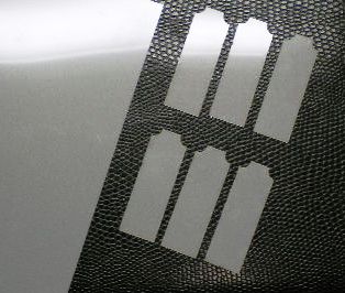

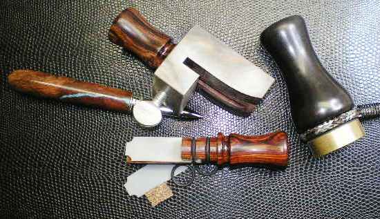

I'm confused. What does the laser do then? I thought you were profiling the inserts with your laser or something.
OK, I mis-understood. If you are talking about just the reed, Yes I am cutting them on the laser now. Any little change in length or shape will alter the tone big time, or just make it plain not work. The tone board I am making using a heat treated jig to cut the length and curve on the board after turning the shape on the lathe. Hope this helps. Please feel free to ask more questions.
