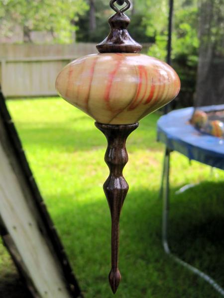

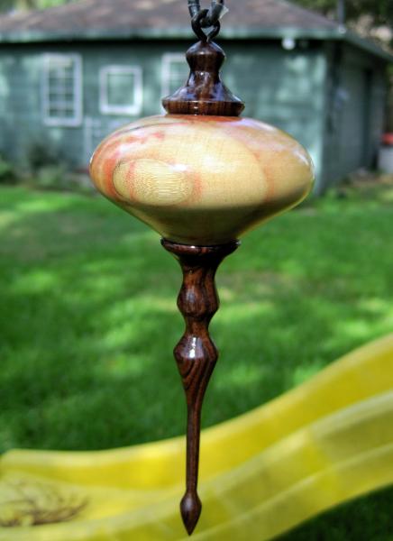

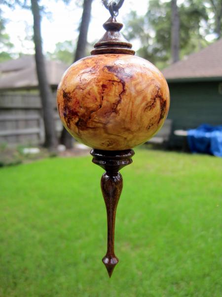

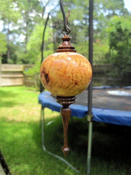

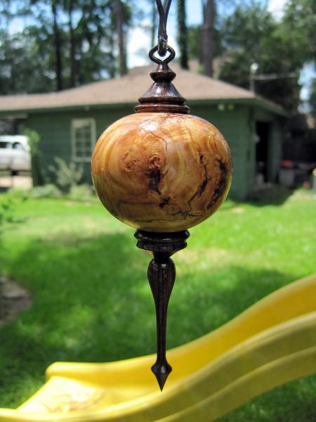

'nuf said. Both hollowed out. Soaked with thin CA to stabilize from the inside. Finished w/ Gloss Rat Can Lacquer.
1st is Famin' Box Elder w/ Bolivian Rosewood finials.
Next is Aspen Burl w/ Texas Ebony Finials.

I bet some segmented would be awesome. Just be careful when hollowing them out. Maybe you could turn them 2 parts like a lidded box and glue them together. That is what I have been thinking about doing with some smaller pieces I have here. I hollowed them using a Sorby Micro Hollowing set I got on sale a WC over a year ago and these are some of the first things I made after making some mini HF's. As for weight, I weighed the FBE one at 26g so not that bad but the Aspen is a little heavier because I got scared and did not get the walls as thin as I should have. I need to pick up a thickness gauge so I get a better feel for wall thickness. The holes are to small to fit my little finger in there to check.

Thanks, I also like the Aspen better. It had some cracks that I filled with epoxy and mica.
