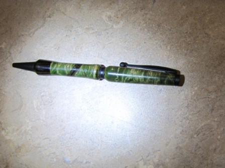

I made a bunch of pink maple pens for a charity. I used scarlett colored pigment (from woodcraft) disolved in water. Then I lightly sanded with 600 grit until I removed enough pigment to get pink. The cool thing is that the harder grains don't absorb the pigment as well, so after you sand it, you really highlight the wood's natural figure. The "curly" part gets very light and the soft wood in between stays more bold. Just keep in mind that the dried color of the figure is a lot lighter than it will be once you add finish. I wet mine with mineral spirits to see what the final color will be.
I attached a picture of one I did in forest green. It is meant to show how the color shows the grain with light sanding. The pen is from my junk pile though, so don't think the pink turns out as ugly as the green.
In no way shape or form is that pen ugly. At least not from where I'm sitting.
