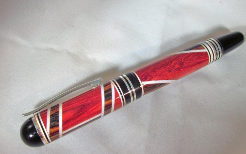

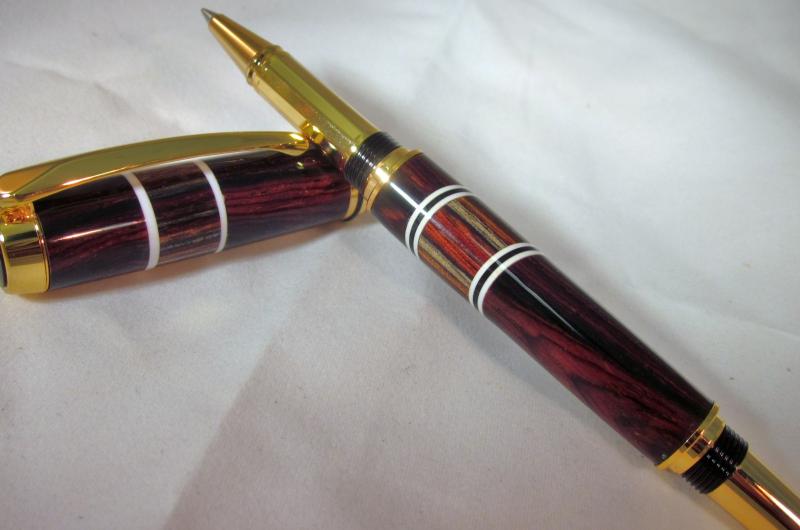

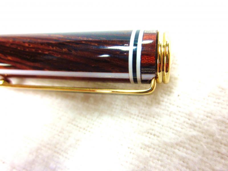

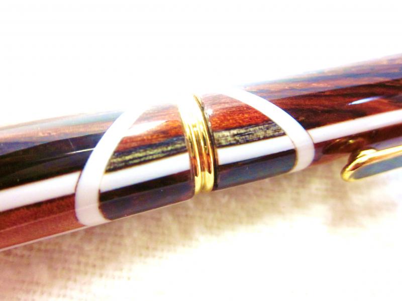

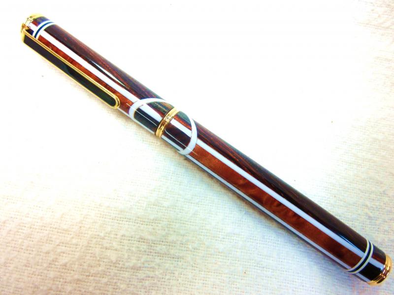

Yup, I admit I like the stuff, but I haven't used PSI's, only CSUSA's. Haven't had any problems working with it. As a matter of fact, I use it exclusively in segmented pens.
