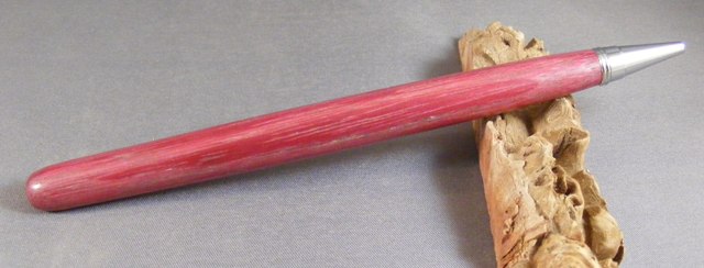

Heres one of my single body closed end slims

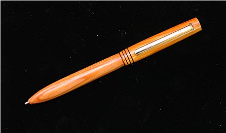

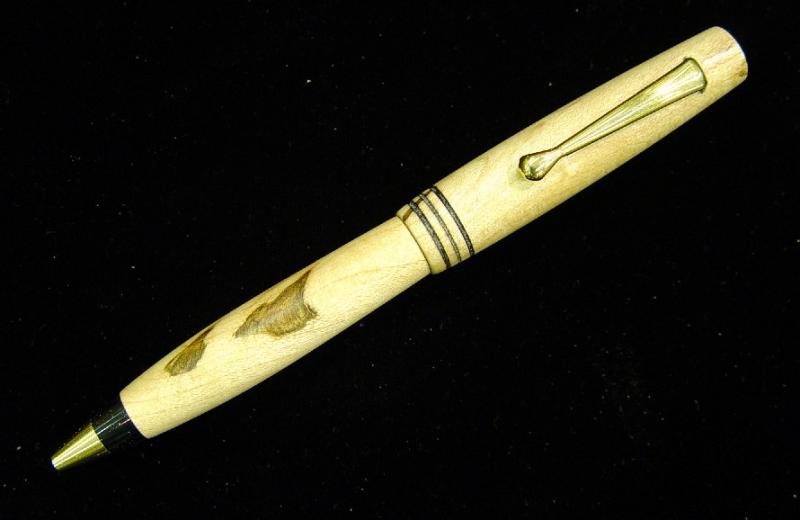

There isn't a pen kit made that can't be closed on both ends with some planning and ingenuity. Some just take a lot more of both.
The SlimLine is more difficult than most because it has to have a hole in one end for the ink tip, and the clip has to be cut and bent so it will fit into a slot in the cap. It would be easier if the clip were not used.
The photo on the left is a SlimLine that is closed on both ends.
I have also atached a photo of the Americana with a closed-end cap. This kit is like the cigar and others that have the transmission attached to the cap. These are not easy pens to modify. I make these pens by drilling the hole and finishing the pen without the brass tube. The brass tube and its attachments are inserted after the pen is finished. That and some epoxy glue is what holds the clip against the bottom of the hole in the cap.
I eliminate as much of the plastic at the tip as possible, but these tips are just too big to be enclosed without the pen becoming too large to be useable. It is possible to eliminate all of the metal fittings at the tip in a plastic pen, but wood isn't strong enough to do that.
