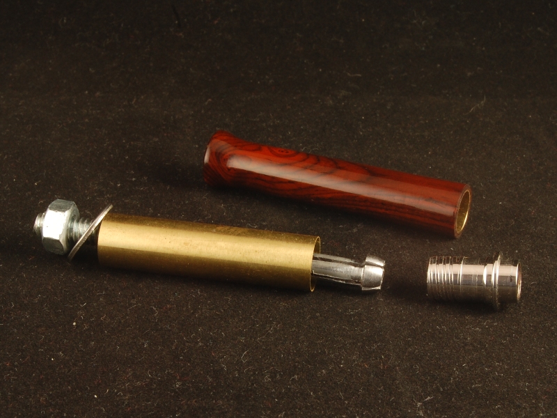

It worked! My device is not as fancy as skiprat's but it got the job done! Turned down the head on a 3 inch 1/4-20, and slit with my bandsaw used a Jr2 cap tube, washer and hex nut. Easy to grip the bolt with vice-grips while turning the nut, coupling pulled right out without harming the threads.
Thanks to all for the suggestions, and especially to firewhatfire for finding skiprat's cool tool!

Why do we split the end of the bolt like that? is it so the claws in effect, can be spread out manually a little?
plano_harry
Jan 12, 2012
1,959
Plano, TX 75093
Since it is a closed end pen the puller has to compress to fit through the coupler then spring back out to grab the back edge of the coupler. Then the threaded bolt pulls while the tube pushes against the coupler trim ring. I hope that makes sense.
