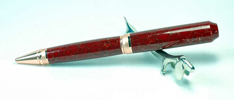

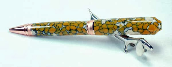

I have done a few but it's been a couple years and I can't remember how it works. I just checked all of the instructions that came with the Arizona Silhouette mandrels and nothing on the Cigar. Think the instructions are on the DVD, I'll try to find it today and post it.
Did you ever do one with a clip?
If iI can't incorporate a clip, I'm not really interested in pursuing the project.
