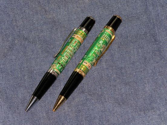

Well here are a few pictures and my thoughts.
It depends on what you do or how you market them. Yes they are all the same but when you sell them one at a time you can get away with it. Only display 2 at a time.
There are some tricks you can do to change it up a bit. Make one in one direction then another in the upset direction.
The seam is not that bad as seen on the first photo. Yes you can see it but it does blend in nicely there is just a thin strip that is a little plan. The gold pen in the next 2 photos has the clip off the seam.
Another trick to mix it up even more is to use different kits. It can be done any type of Sierra kit even the click. Check my site in my signature or my add in the business classifieds for tips of how to do it.
Any way my vote goes for hide the clip.
