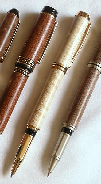

One "rule of thumb" I've heard is that you almost always want a slight bulge (convex curve). On the other hand, I did a Navigator in maple with a concave curve on both the cap and the lower barrel and I loved it! (I gotta do another one of those.)
Just how "concave" are we talking about? I'd love to see a shot of it... Here's my misguided idea:
Strange - reading the IAP on line, I don't see any photos or links or anything (although apparently "greggas" did). There were links in the e-mail notification I got, but when I follow them, I get "Internal Server Error". So I can't see your pen. :frown:
As for mine, there's not much wood there so it's obviously not too far from flat. I don't have a photo of the pen by itself, but here it is cropped from a group shot.
