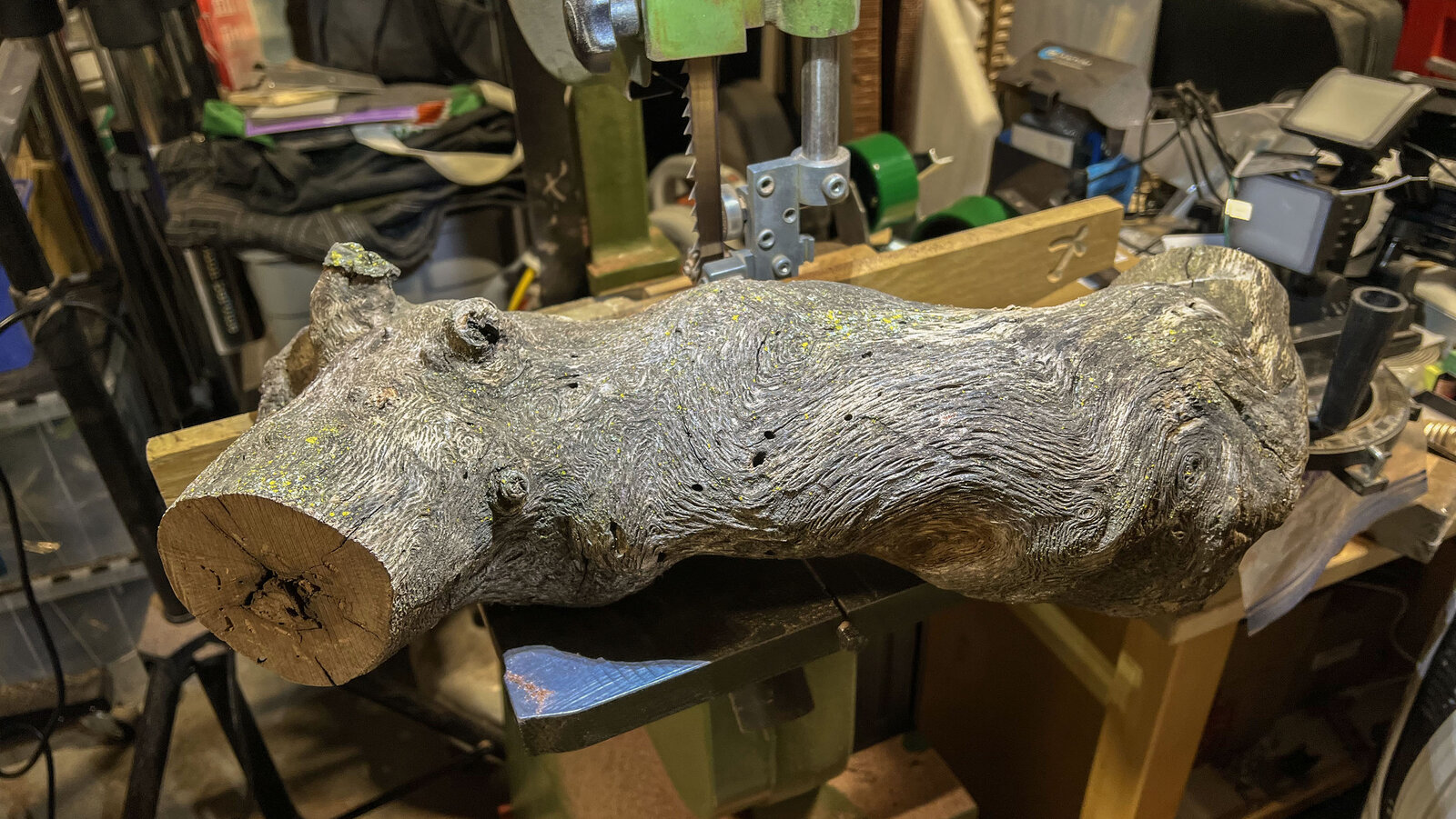

The first challenge was just cutting up a bunch of pieces and seeing what was inside - I made 5-7" pieces with the chainsaw and then split them open on the bandsaw. Our yard is 2 1/2 acres of mostly Coastal Oak with some Manzanita - The oldest Oak is between 150-200 years old but most are much younger.
A downed branch from the old oak yielded several pieces like this one on the bandsaw -
While there might not be a single piece that's completely undamaged, I decided to see if I would work with the damage and just make a pen anyway.

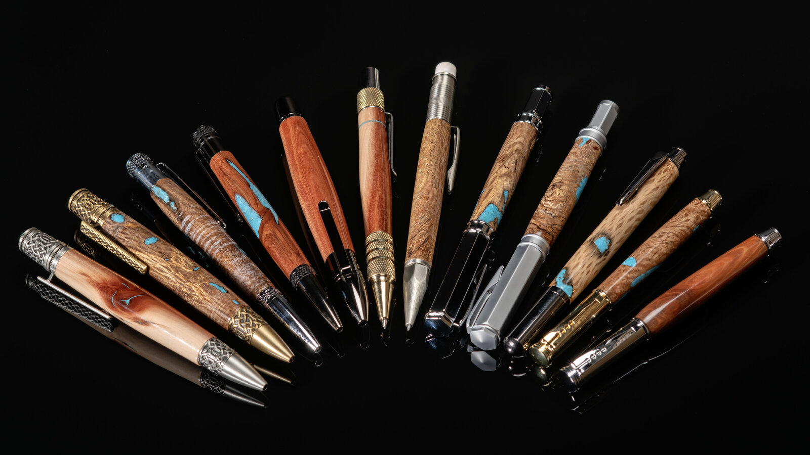

I am far from mastering the technique but its improving and all of this years Christmas Pens are from the yard - There are 16 total but some got wrapped before the photo...

Outstanding work! I think you did a great job on those! I am sure there are going to be some pleased recipients of those gifts!
Not all of those are out of the oak - did you use some of the Manzanita you mentioned? I have made several Manzanita pens and love the wood!
Great job and Merry Christmas!

Wonderful work and way to take advantage of the fallen wood.
I'd be tempted to use colored epoxy but the turquoise sure turned out pretty.

You did that old piece of limb justice! If I had those trees in my yard I would need a bigger shed to keep all of the fallen limbs in! They all look beautiful but I am a huge fan of the oak and its character. Great work!

I did - and its great wood - it polishes to a semi-gloss even without a finish - the blond and brown in one piece is common - Turns great and is quite hard - just a little harder to come by -

Fortunately, I can "store" a lot of dead limbs on the trees if they aren't posing a hazard - but I do have a job box full of Manzanita and a couple piles of potential Oak - and almost equally important, a fireplace for things that aren't usable or interesting.

I'm hoping to use some that have fire scars - but will have to fill the space with clear epoxy to make a blank - they aren't stable enough to bore through - so planning to play with some epoxy soon - would like to be able to more or less stabilize with epoxy but may have to go the Cactus Juice route - want to be able to see into the voids rather than blank them out.
