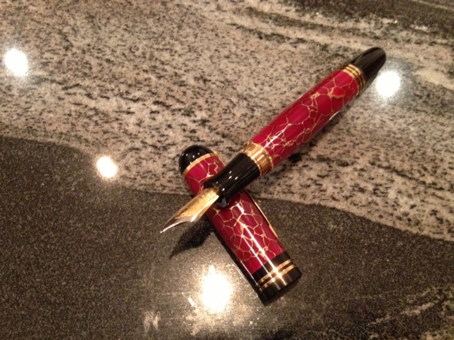

Attached is my first venture into fancy stuff, but while taking the picture I noticed that I have cracked the cap when putting on the finial. Another of my trial and error learning experiences.

Did you make all the components in that pen? Cause it looks pretty awesome to be the first thing shown after joining here. :)
BTW - You should post the pen photo over in the Show Off Your Pen section. Not everyone looks at the posts in this forum.

Wish I could say that I made the bits and pieces, but I'm several years and many tools away from being able to accomplish that. It is a Churchill kit pen.

Another Greeting from Washington State. Here's something that I learned from Barry Gross' Acrylic Pen Turning Video. He said that the ends of acrylic blanks are very brittle and can crack easily during assembly, especially if you try to force the pieces in at an angle (not good with any kind of blank, but we've all done it) Anyway, he strongly advised purchasing a chamfer tool to ease the assembly of acrylic pens. I purchased a chamfer tool from Ariz. Silhouette and it really helps with assembly, and especially reduces the number of problem kits that I used to have to wrestle with. I bought the chamfer tool several years ago, and just recently Barry Gross purchased Ariz. Silhouette. I am not trying to encourage a sale, just telling you that for me, it works. And with the cost of acrylic blanks sometimes eye poppingly high, you don't want to lose one.

Thanks very much for the suggestion. I do, in fact, have a chamfer tool (from Arizona Silhouette) and used it on this. I took the pen apart and think the problem actually was a repair I made when turning. I piece of the blank did chunk off the end when I was turning it. I was able to find it and CA it back on. I'm guessing that area was still weak.
