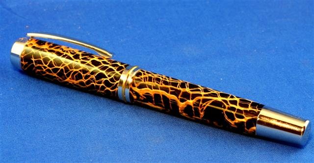

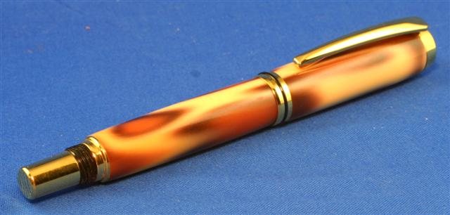

The jr gent FP is made from one of Ed's cat blanks...its the leopard I think. I must say that the cat resin is the finest I've ever turned. It turns like a dream, sands wonderfully and polishes to as much of a shine as is desired. Thanks Ed for giving me this opportunity to experience this great material
The Gent rollerball is made from one of Curtis' cactus blanks. It has been in my "to turn" stack since last October and I finally decided to use it. It was a clear one and I painted the inside black. I've turned one one of the black resin blanks and I must say the clear really allows the depth of the cactus to show. I like the depth and dimension that the clear gives. I was a little dissappointed in how much work it took to get the Alumalite to polish and shine. I think I need to visit with Curtis before I make the next one, or do some searching in the archives.
Enjoy and comments welcome...whatever they may be.

Can someone provide information on the steps to paint the tubes black prior to gluing them into the blank? I have a couple I will be turning soon - I would rather not make any mistakes.
Also - is the black more difficult to polish? What is alumilite?
Roger,I paint the surface of the hole in the blank and not the tube. Painting the tube allows the glue to show between the blank and the tube. That's worse looking than the brass tube showing a little. Painting the inside of the blank's hole has worked much better for me. I use model airplane paint and the cheapest artist brushes I can find. One of our "dollar" stores has a pkg of 15 artists brushes for...you guessed it....$1. I use and clean them until I forget then toss'em out.
The cactus pen I posted is clear alumilite (I spelled it incorrectly in my original post). Alumilite is a urathane resin. It polishes nicely but I've just not turned one or two alumilite blanks and wasn't familiar with the best way to sand and polish it. Read more about alumilite here: http://www.alumilite.com Several who cast their own resin blanks use alumilite and others use polyester resin and epoxy resin. I usually sand to 1000 then swithch to micromesh and wet sand 1500 - 12000 and buff with a swirl and scratch remover such as McGuires #7. The resin type and color don't seem to matter. When using micromesh be careful with heat from too much pressure. The heat melt the MM and marr the blank. This mostly happens when using MM dry. I've been getting much better results with using it wet. If MM is not available, then use the wet/or/dry paper available at most auto parts stores.
I have both kinds to turn - so any help in advance would be greatly appreciated!
By both kinds I assume you mean clear and colored. Search the archives for finishing acrylic or plastic or resin blanks. Watch the videos in the library by Ed Davidson, aka YoYoSpin. I think he has one on turning and finishing resin blanks...especially polyester resin. He calls his EPR: Ed's Polyester Resin. Good luck with the blanks.

Don: I have a couple of those cactus blanks...the clear ones... but have held off on making them up because they didn't really appeal to me. OTOH, I really do like your black ones!! I have two questions for you.
1. The cactus skeleton (if that is what you call it??) has a sort of red/orange/yellow in your picture. Is that a photographic illusion or is that a real color? Is the cactus dyed to achieve the color?? The ones I have are apparently "natural" which is a sort of unexciting tan color.
2. In your picture, the blank looks very black. I'm guessing that some of the "blackness" (if not most) is due to the photography and that in person, the blanks are more obviously clear.
I would like to hear your comments as I really like the idea of a black pen with highly contrasting internal details. I'm thinking I should get some of the black blanks rather than the clear??

Randy,
I am not Don obviously but since I made the cactus blank in question, I can certainly answer some of your questions.
I believe Don's photo is a little off color wise. The skeleton in the cactus pen is not dyed and is actually more creamy than his photo shows. Cactus skeletons do not take dye very well. I have tried just about everything I can think of and it just will not penetrate and change the color!
I don't think the blanks that you have were made by me since I don't recall ever selling you any so I can not really speak to what you have. I would try drilling them and painting the inside black with the blackest paint you can find and turn one of the barrels. If you still are not excited about them then abandon it!
Some people like the black resin cactus blanks that I make but most prefer the clear with black inside. The advantage of the black resin is you do not have to deal with painting the inside but the drawback is you loose the 3D effect that is most popular with this blank. Go to my website if you have a chance and you can click on each of the colors I offer to see an example of each. Let me know if you have any questions or if you want to try one of the all black ones.

Hi Randy,
I was answering your questions earlier this morn and had to leave before I finished. We had 95 mph winds with a heavy T-storm and I had a call from someone that needed help with a fallen tree.
Now I see that Curtis has answered your questions. And, yes the color did shift for some reason. The actual color is a creamy white/tan and the inside of the hole was painted black. I like the depth from the 3D effect instead of just the flat cactus on the surface of the black dyed resin. Do a Curtis suggested and take a look at his website to see the difference in the dyed and clear blanks. The clear ones rock! ... well, both do, but the clear ones rock a little more robustly. And, you can choose any color you like. I use model airplane paint.
