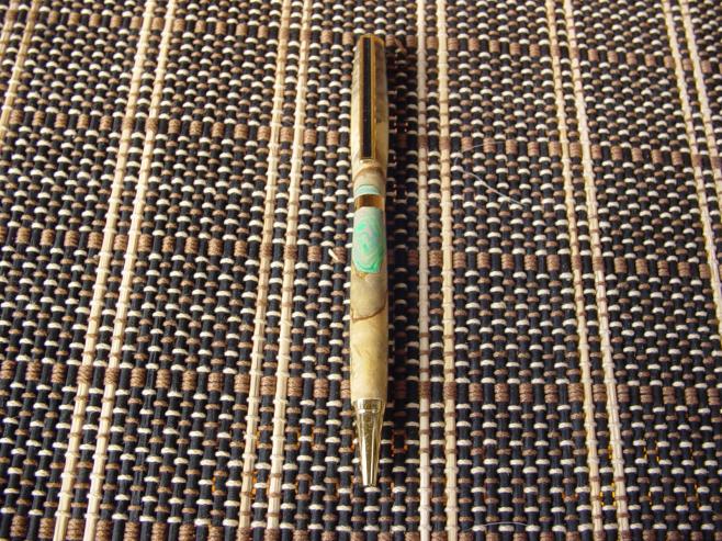

Well it works!!!! Here is a small voided casting blank of buckeye I had recieved from Rocky B and tried it today....I wired brushed the area to be filled, applied c/a on area and put in the poly and baked for 20 minutes..:rolleyes:

Looks fine, but I agree with the caution about wood expansion and contraction with polymer insets. I've done polymer clay wrapped turned wood, kaleidascope easter eggs (with sculpted ducks and egg baskets and bunnies no less!!) in the past and pretty well vowed not to go down that path again.

Skeeter, now why did you put that pen onto that whatever-it-is for a back ground???? I wanted to see what you did and I am not sure.
