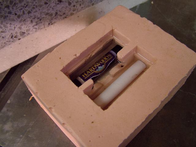

Something along these lines.. one is the tubes in a mold. One tube has
a label on it, done on an inkjet. The mold is full of resin. The other is a
'finished' reject. I put the kit together just to see how it would look, (and
because it was one of the only ones that didn't have air bubbles in it..) but
there's a crack on the back and it is pretty ragged on the ends. I think I
turned it too soon.
turned it too soon.
What is your mold made of ?
