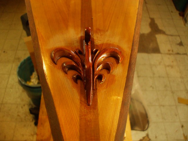

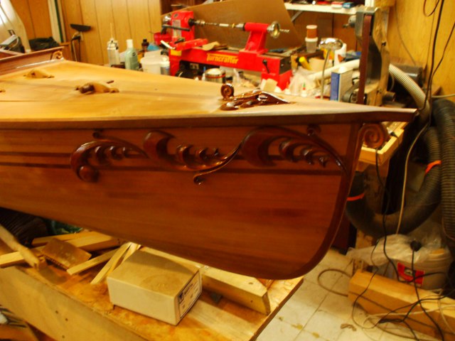

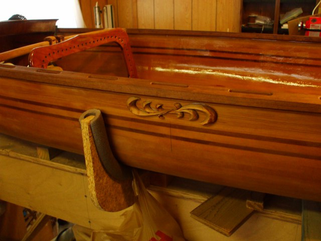

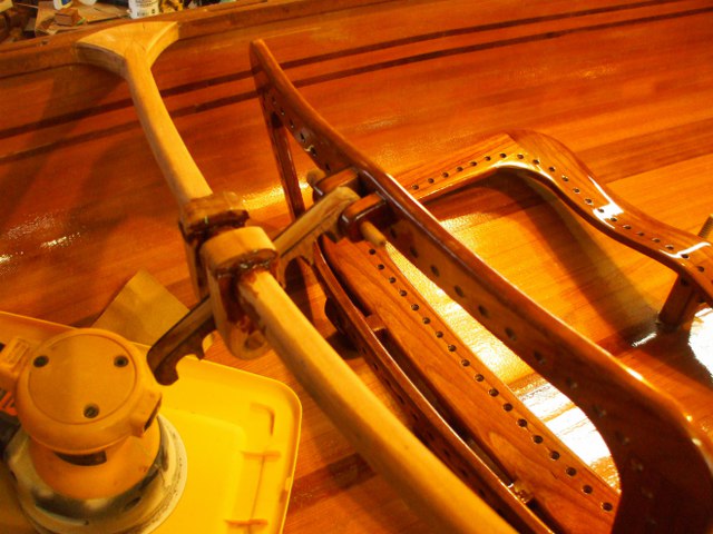

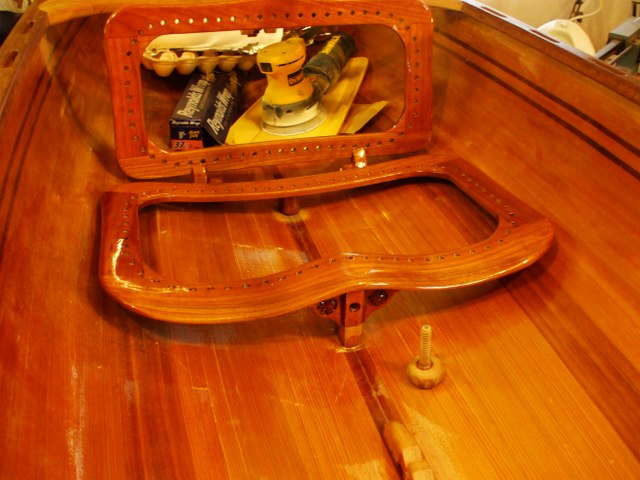

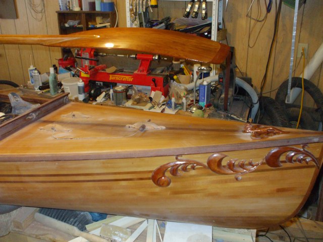

this is a canoe designed by mac mc carthy of feather canoes. it was designed as a very basic boat so i did what i like best........upgraded it! it is western red cedar with a fiberglass/epoxy coating, black cherry and brazalian cherry. everything in the boat is handmade and wood only. hinges, latches, the screw that holds down the seat.......everything is made of wood..it is still in process so you will see places sanded, in need of being sanded and maybe a pencil mark or two but soon everything will be coated with 10 coats of captains varnish. multiple caots allows for some major sanding. i will also hand cane the seat and seat back. the seat back is adjustable like a lounge chair. the seat and the thwart(piece behind the seat) are made from 64 layers of very thin black cherry. all the carvings are my design and carved by me. the boat is 12 feet long and 28 inches wide. it currently weighs about 30 pounds....
oh yea...there is also a matching hatch and compartment and carvings on the stern.
and yes, i know my shop is a disaster but it's my disaster and i know where things are.......
questions comments are welcomed. thanks for looking...bear
