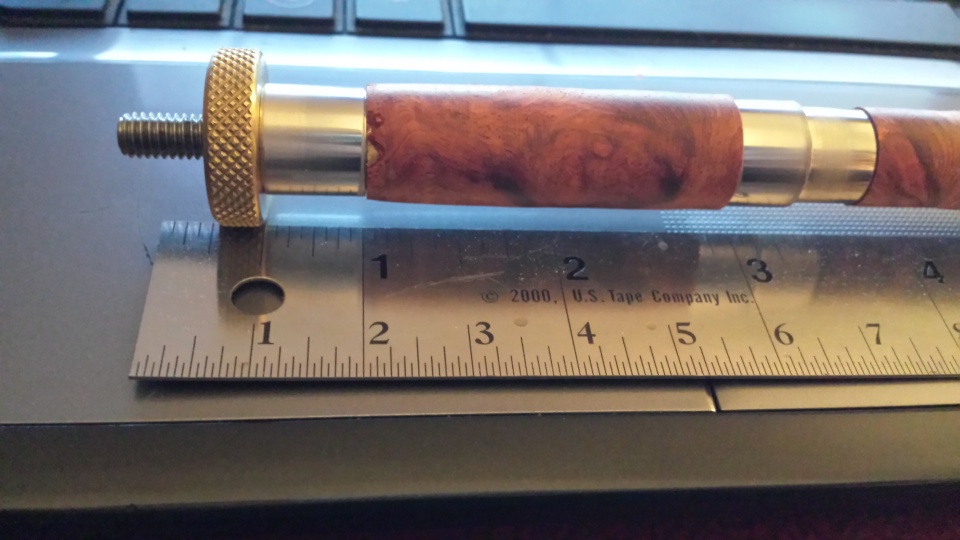

Hi folks,
I'm working on a Majestic Jr in Amboyna burl. As I was turning it round a bit chipped of one of the ends. Being the, uhm, "frugal" person I am, I'd like to try to save it.
It came off the short barrel which I believe is the cap. I figure I'd need to trim no more than 1/8th of an inch to get past the bare brass tube. Would that affect the fit of the components?
Thanks,
Carlo.

Lay all your parts out on the workbench and see how much room you need in the cap for the nib. Also consider your clip length making sure it stays on the cap length.

if you have an end cut of the burl... (the waste when you fitted the tubs) make some fine saw dust with sandpaper ... pack into the chip and saturate it with CA glue... you wont even be able to tell there was a chip there after you sand and finish the blank :) :)

Hey Carlor! happens to the best to the best of us, personally when this happens to me i would take the tube off the mandrel and sand down the end until you have sanded far enough down that the chip is gone, having the tub an 1/8th inch shorter on the cap is not a problem for this particular pen kit and that the pen still looks flawless :) hope this helps

Thanks for the advice, everyone. I think I'll try with the sawdust/CA idea first. If that doesn't work, I'll try the measuring/trimming. If that doesn't work I'll just have to abandon it and get new tubes and another blank to go with the kit.
Since I'm in a time crunch, I'll have to put it to the side and start another.

Thanks for the answer. Whenever this has happened to me in the past, I've simply turned away all the wood and reused the brass tubes but I don't usually turn high end kits with expensive blanks.

I would try the CA/saw dust repair first. That should look pretty good. If you don't like it... you could put a contrasting oops band on the ends of each of the cap and post tubes. Just a thought. Been there and done that too many times. Good luck!
Then hide that portion with the clip.
Oops. Didn't read the post above, already suggested.

Not sure where the clip goes on this pen. If this chip is the top, after you make the repair and when assembling the pen put the clip over that spot and it will never never show.
Figure all this out before pressing the pen together. Yes you know why I know to say that.

I do believe the cap on this component set can easily handle losing that fraction of an inch in length. The clip would sit a little lower but I think there's enough space it wouldn't be metal on metal.

I have a different opinion.
The chip is large relative to the size of the pen.
Shortening may throw the balance off--might not, but possibly.
More important, sawdust and CA will never look as good as a beautiful Amboyna blank turned proper.
Ebony rings would look good as would other solid bands.
You're not making a cheap object; don't sacrifice quality.
My $.03--FWIW to you.

I am very late to this party...but have use crushed turquoise colored stone and CA and was very impressed with how it came out. Just another idea. I did have to cut out more of the burl to make a larger area of stone.

I'm with Mark on this. If that ever happened to me, and I'm not saying it has and will deny it if those at the demo speak of it, I would "redesign" the original concept and tell no one.

Slidell, LA
