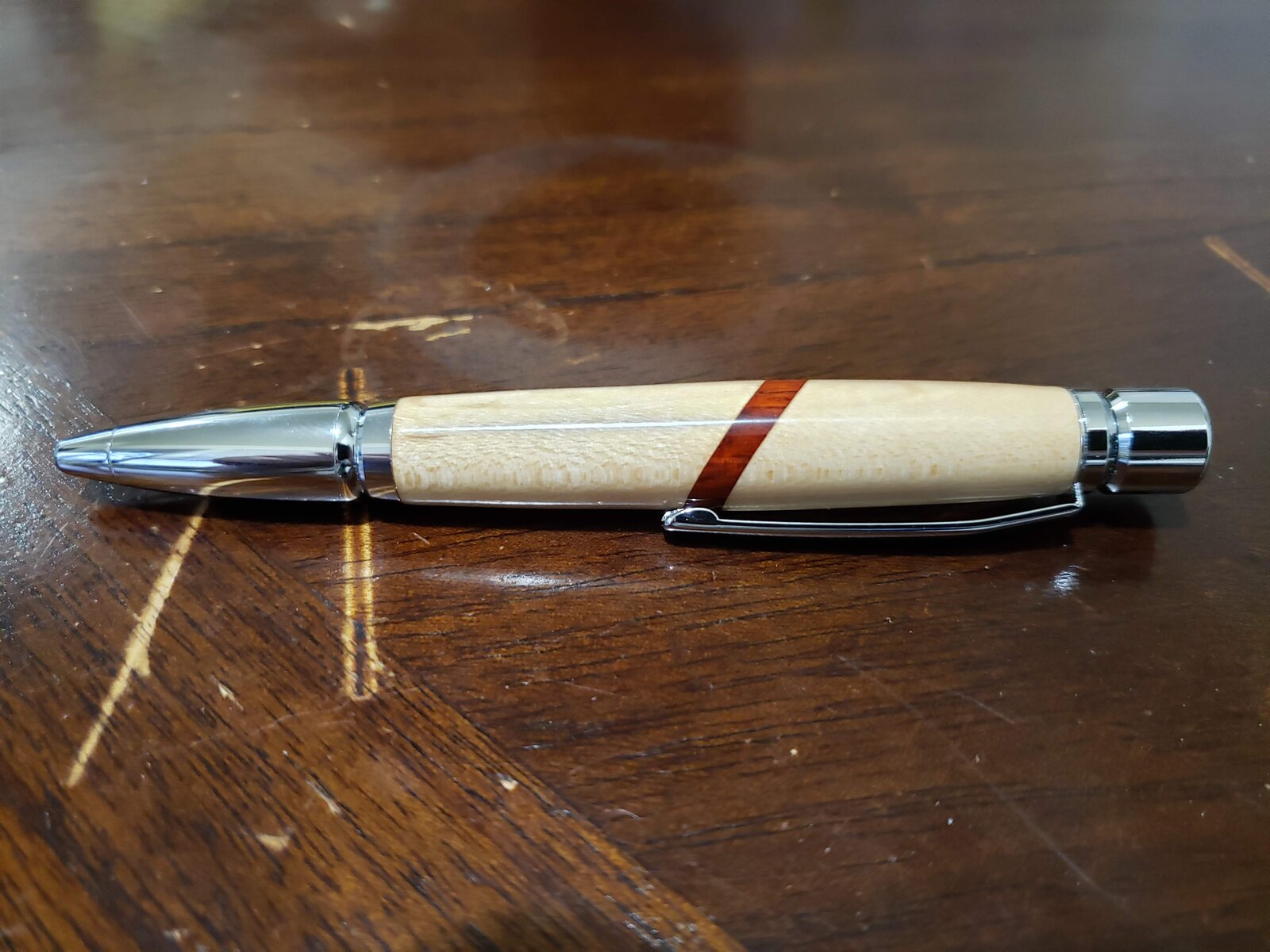

Finally got around to turning the Protura kit I ordered with a maple and paduk blank I made years ago. Seeing it in person, I'm not a huge fan of the design, but I have no complaints about quality. The metal finish is good, all the moving parts work well, it was no more difficult than any other pen to assemble, and the final fitup is great. If the styling is up your alley, this is a great pen.
cl1237
Nov 9, 2022
107
Lancaster, OH
Thanks for the review Vince, and nice blank, simple but elegant. I was eyeing these in the newest PSI catalog, I'll pick up the starter set.
