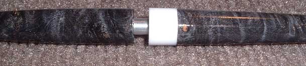

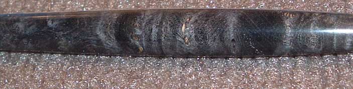

I've been doing some experimenting with polypropylene bushings.
CA cannot make a bond to it without first treating the surface.
I remembered that when I first tried to make a mold with this stuff for casting PR, the CA glue quickly let loose and the mold fell apart.
Below is a trial run using a blank that I could not get finished correctly.
The idea here is to make a poly spacer just a little larger then the blank size.
That way the CA buildup is outward from the blank and does not roll over the edge.
The poly came from a small cutting board sold at wallyworld.
I will complete this test and if it proves out I'll do a writeup on how to easily make them for either TBC or a mandrel.

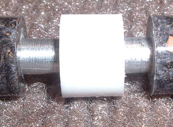

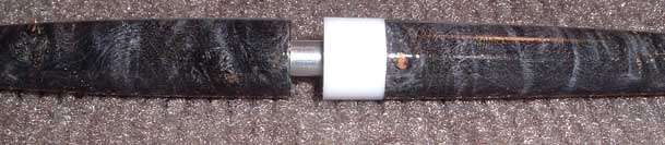

Dale Allen
Oct 27, 2012
1,384
Massillon, OH
After a little more work the seam where the 2 piece meet is nearly invisible.
I think I'll make some more of these polypropylene bushings for more sizes.
