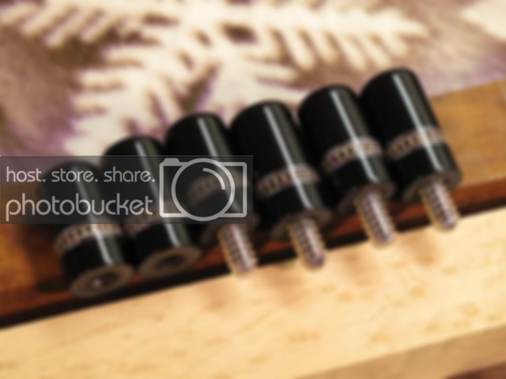

your sanding to fine 320 max if you are going ebony to any other light colored wood .
compress air shooting on the wood as you are sanding.
metal rings will always pop after time. make a mandrel for the metal ring.
cut and polish to size then only sand the wood to the rings. and ca as you sand is a good idea too.
epoxy finish
on the 2nd piece over from the left lower part walnut into purple heart ,
is this what you are talking about.
ca finish
