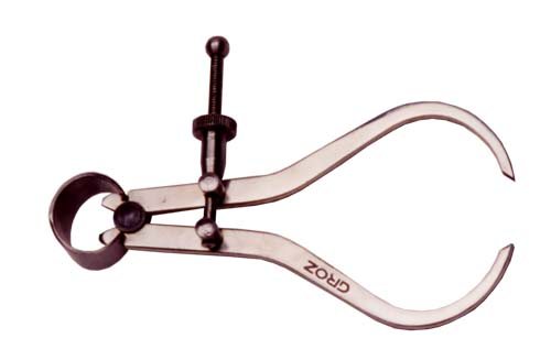

I don't use a calliper anymore. I use something like this :
<br />
Don't need to bother with numbers.
I adjust it to the actual hardware I'm going to use and I'm always on the dot!
