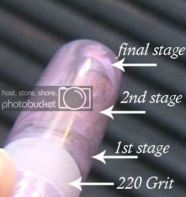

I've been asked by some if I could post some pics of my three stage buff finish.
I can't get the detail on the camera like it looks in person, but if you look close, you can see the ridges in the first stage, then the dullness in the second and the shine in the last stage. After turning, I sand with 220 grit only and then to the wheels. Only takes 30 seconds or less to finish a pen.

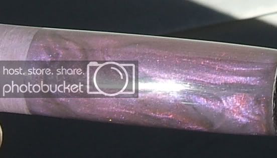

This pic shows the final finish a little better. You can kind of see the progression down the blank. Some of my other pics came out much better on some other blanks with this same process. I can post those if someone wants to see a better pic of the finish.

I readily admit I don't see well, but I think you are just NOT going to be able to take pics that will show the transition.
I tried to do a video and was totally unimpressed with that, too.
I AGREE completely with what you are TRYING to do, just to eliminate any doubt---good luck!!!

I don't use the Beall system, I have dedicated buffing equipment and use high quality materials. The better the materials, the better the finish.
I NEVER use wax, it will actually dull a fine finish. I only sand with 220 grit after turning to insure the surface is level because it WILL show. I then use three compounds in progression with the suited wheels. I've been selling these compounds to the car guys for a little over a month and several have asked for more. Anyone should be able to at least improve their finish with this method and materials.
After turning, I can literally finish a pen in 30 seconds. So yes, MM is a huge waste of time and the finish isn't nearly as fine.
I was just trying to show the results rather than trying to convince the non-believers.

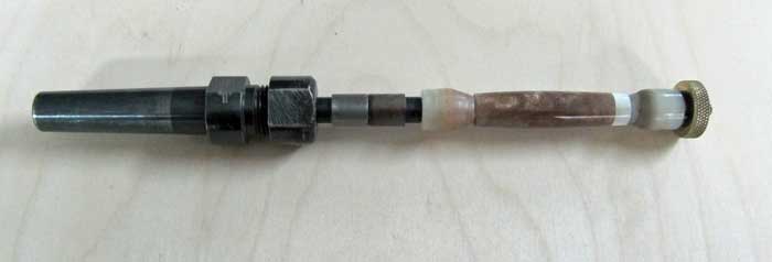

What does everyone use to hold there work to buff it?
I'm always worried on a CA finished wood pen that the buffing wheel will tear away the CA finish at the rim of the barrel? Similar to if you have a bit over the rim and press a pen together! Or am i wrong, as i know a lot of people buff CA finishes as well as Acrylics.
PHIL
I use a retired mandrel and johnnycnc's Eliminator bushings for both buffing and applying CA. Buffing at a low speed with a light touch shouldn't damage the CA finish.
