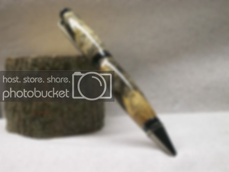

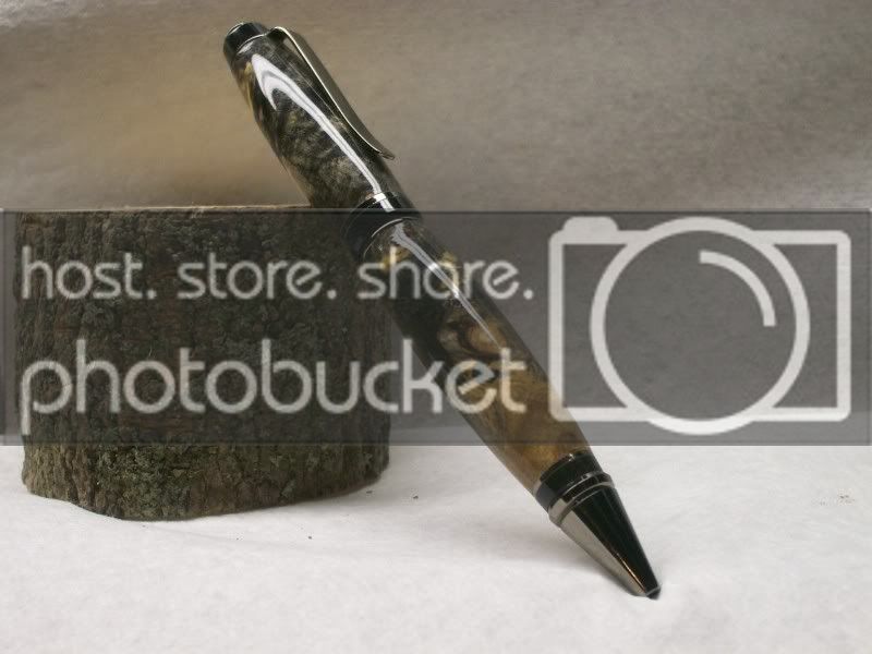

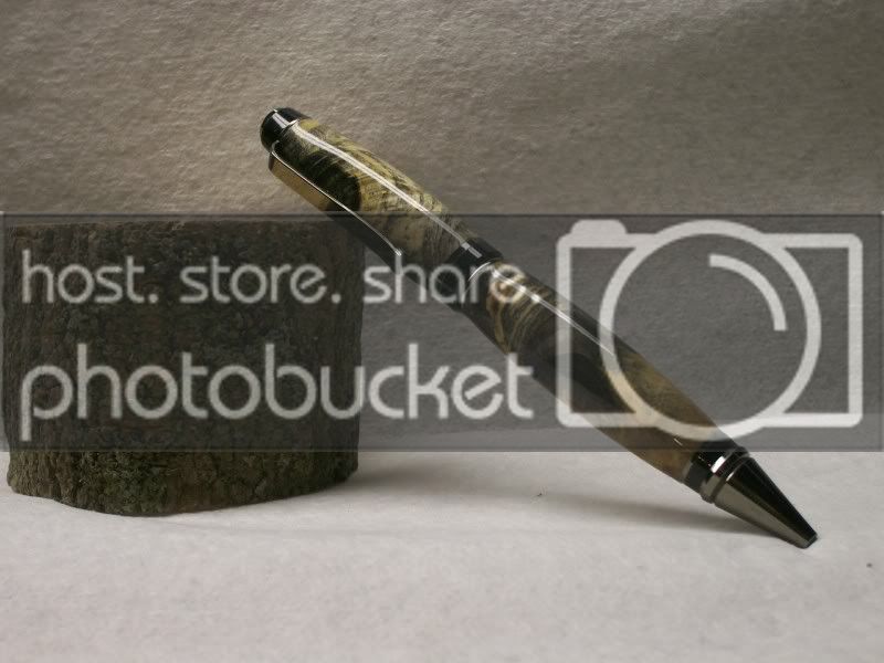

Well, in the midst of my self-destructing chaos of a vase I am constructing, I managed to make my best pen yet, IMO. It is a Buckeye Burl I snatched outta the pen swap. This sucker had a MAJOR surprise. As you can see in the pics, there is a knot on the lower barrel. When I just got it to round, I felt it to check it out. It felt funny. Turned the lathe off and saw the tube. This knot was hanging on to this tube with some freak strength or something. It was as though someone somewhere KNEW the struggles I have been having this week and had some mercy on me lol. Anyhow, I did what I think was the right thing. It worked either way. I grabbed some of the shavings/dust that had been created laying on the ways and put a glove on. Squeezed some CA into the pile of dust and made kind of a slurry. I then pushed it into the voids and let them dry for a bit. Turned them down and it was solid. Lucky for me this is a burl and you wouldn't know up from down. Otherwise, I'm sure it would've stuck out like a sore thumb.
My best fit thus far, by far. My best finish without a doubt in my mind. And, I just love this pen.
It is a gift from my fiancee to her uncle for the same gift exchange I am making this other piece of crap for lol. He is a big-time union guy around here, and has a desk to work at. She figured he would be able to appreciate and enjoy a writing instrument such as this. So, without further ado. I present my Buckeye Burl Black Ti Cigar.
Comments/critiques please.
P.S. Anyone know if I can put something like a gel ink refill in this, and would any parker style gel refill work? Thanks.

That finish looks great. Yes, you can put a gel in that. Any parker refill work. Anthony Turchetta aka Penworks has some nice Visconti gel refills that would work that write very nice.

WOW that is an outstanding pen. Nice fit and finish and the blank is a gem. Sometimes things just have a way to work out. Thanks for showing.

Very nice work and great finish! What kind of finish did you use? It looks to be about an inch deep - my compliments!
Buckeye burl is the BEST, though it can also be the most challenging. It gives you plenty of practice filling in voids and blow-outs. I usually fill with the shavings, have used turquoise, brass filings, shavings from other woods - some guys use old coffee grounds.

Thanks guys, I appreciate all the comments. The finish is 8 coats Med CA. I use a modifiied method of DJ's that was referred on another posting here a while ago. I turn to size using mandrel-less and calipers for dimensions. I then sand from 220-12000MM. Apply CA using paper towel and hitting with accelerator between coats. Then MM from 1500-12000 and 2 apps of Meguiars PlastX. I'd say the whole finish takes less than 10 minutes. I am still lacking in the turning area, so that takes most of my time right now. I am getting better at it. I think this was about the 25th or so I have done. Thanks again.
