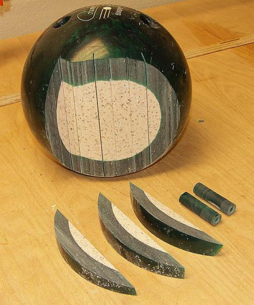

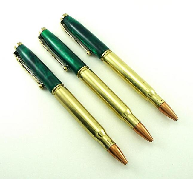

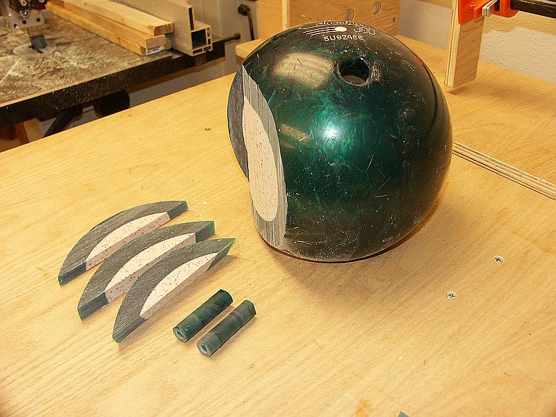

As part of several memorial pens, I used my late mother-in-law's bowling ball for material and it worked very well. I first placed the ball in a small plastic dish to stabilize it while I cut off a thin slice from the "bottom" to make a flat surface. I used my bandsaw with a regular 3/8 inch blade on it, and it cut fine. It does get a little messy with all the small particles produced. (Tip: the bowling ball will dull the blade, so use an older blade for this if you have one).
Now resting the ball on the flat surface, I made several radial cuts about 1/4 the way into the ball. Each piece had a maximum width of about 1 inch. Finally I made a cut perpendicular to the radial cuts, freeing up the individual pieces as seen in the photos. Even though the surface material is curved, I was able to get multiple half blanks over 1/2 inch in diameter that work quite well for slimlines and such.

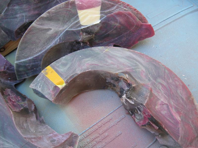

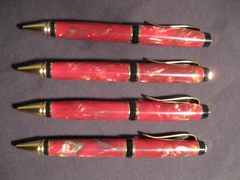

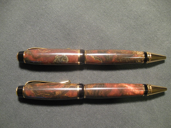

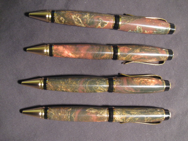

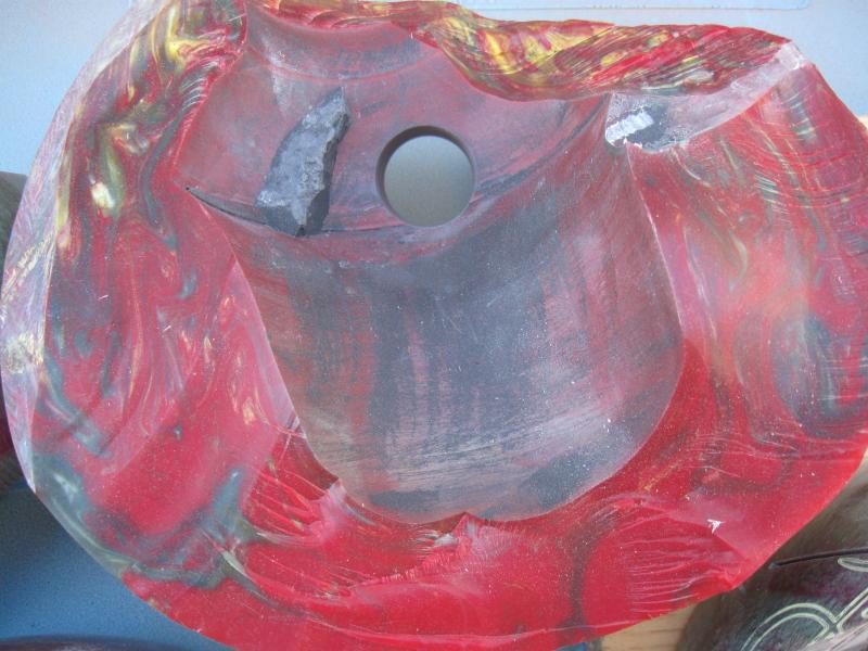

Cores are different when I first started cutting mine the core actually sparked so I stopped right there. The next thing I did was take a small battery powered circular saw and cut a ring around it and then used a pry bar to split it and then did the same to each half. At this point I was able to hit the core with a hammer and most of it would come free and then I found a small blow torch would actually make the core turn soft so it could be removed but in the end too mauch work and very little if any profit in the pieces imho.
I have attached a few pics of what I made and still have for you.
