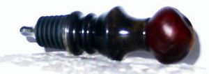

Don't expect a quality CA finish if you put lots of sharp beads or coves in it. I made this bottle stopper a while ago,
And I probably spent 3-4 hours getting the finish just right. Next time I will probably set up to spray laquer if I do one with the sharp beads and coves.
